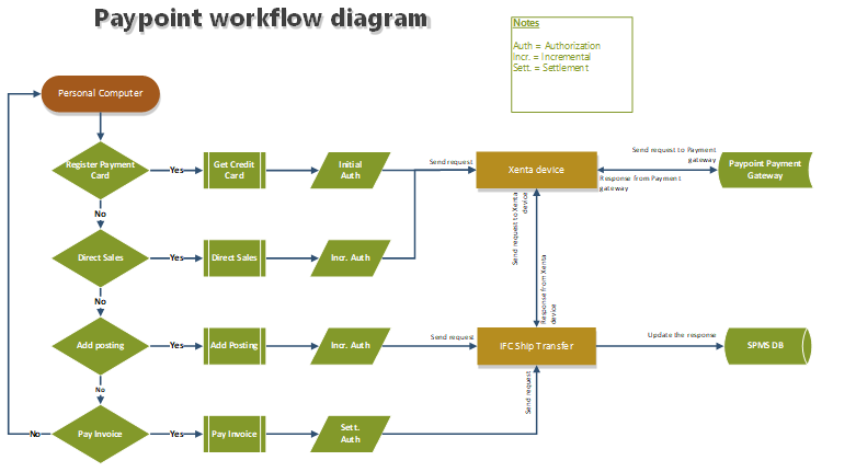

Paypoint Workflow
The SPMS application communicates with Paypoint device through a TCP/IP protocol and the device handles the communication with the host through its own network card. The IP address is stored in the Paypoint device itself.
Send Initial Authorization
Authorization requests performed at Management module, Get Credit Card or Advance Quick Check-in module, Get Credit Card/Direct Salesare sent to the Paypoint device before passing them to the Paypoint Payment Gateway.
Send Incremental/Settlement Authorization
An Incremental/Settlement request performed at Management module, Add Posting / Pay invoice function is sent to OHC Ship Transfer module before being passed to Paypoint payment gateway.
Figure 5-1 Paypoint Credit Card Handling Workflow
This figure shows the Paypoint Credit Card Handling Workflow
