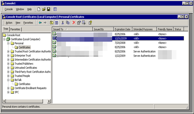

When opening the MMC for “Local Computer” certificates, you should see something similar to Figure 1–1 Console Root Window below. Notice the Certificates (Local Computer) / Personal / Certificates is showing the new certificate.
Figure 1-1 Console Root Window
This figure shows the Console Root Window
When opening up the details of the certificate, you can see at the bottom, “You have a private key that corresponds to this certificate.” This means the OS Key Container public/private keypair is associated with the certificate in the Certificate Store, and you can decrypt items as they come into this “BizTalk” Node.

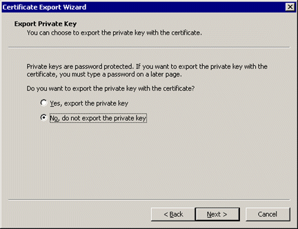

  3. Within the wizard, select NO Do not export the private key, and click Next.
    Figure 1-2 Certificate Export Wizard —Export Private Key
    This figure shows the Certificate Export Wizard — Export Private Key

  2. Within the wizard, select YES export the private key, and click Next. See Figure 1-2

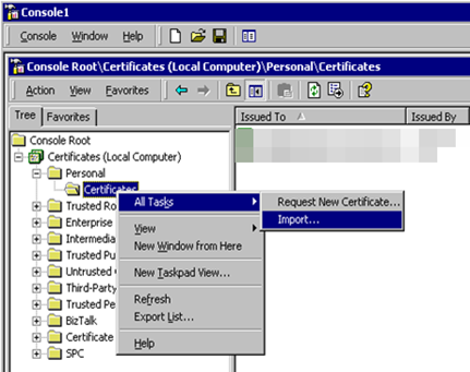

  2. Right click the Personal, Certificates folder, select All Tasks, and then select Import.
    Figure 1-4 Certificate Container
    This figure shows the Certificate Container.

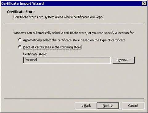

  5. Select the option Place all certificates in the following store and use the default Personal store.
    Figure 1-5 Certificate Import Wizard — Certificate Store
    This figure shows the Certificate Import Wizard — Certificate Store
