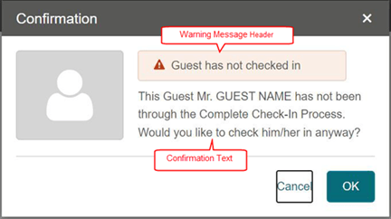

Check-in validation
Guest / Resident
You need to enable the Gangway, Check-in via FC Security parameter for check-in.
A registration confirmation message appears for the reservation that has not complete the Check-In process. The default confirmation message is “<Profile><Salutation><Full Name> has not been through a complete Check-in process. Do you want to check-in?” You can customize the confirmation message header to include profile salutation, stateroom, nationality or others using the predefined codes from OHC Administration module, Administration menu, System Setup and then Labels Setup, GNG120.
As for the warning message appearing on top of the confirmation message, the default is “<Profile> has not checked in”. You can define the warning message header in Label GNG123.
Figure 15-24 Check-in Validation
