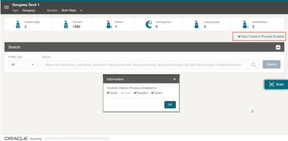

Enabling the below three parameters will also turn on the ‘Auto Check-in Process Enabled’ link in People Movement Page. See below figures for more information
  • Gangway, Check-in via FC Security
  • Gangway, Check-in via FC Security-Crew
  • Gangway, Check-in via FC Security-Visitor
Clicking the “Auto Check-in Process Enabled” link will show the profile type that you can Check-in.
Figure 15-21 People Movement — Check-in Process Enabled
This figure shows the People Movement - Check In Process Enabled
To check-in,
  1. Search the record manually or scan the barcode of the board card. See the Manual Profile Information Search section and Scanning a board card section for more information
  2. For any reservation(s) that are not check-in, the system prompts a check-in confirmation message. See the topic Validation Messages - Check-in validation for more information.
  3. Select OK to continue the Check-in via People Movement process or Cancel to terminate and return to People Movement Page.
