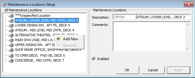

Setting Up Maintenance Codes
Figure 9-65 Maintenance Locations Setup
This figure shows the set up window of Maintenance Locations.
  1. From the Maintenance Setup menu, select the Locations.
  2. Right-click the left pane and select Add New.
  3. Enter a code, description, and comment.
  4. Click OK to save
You can also use the Customized Location as a sub-category, to further define the location, for example, vending machine at bar area, open shower at Pool Deck.
  1. From the Maintenance Setup menu, select the Customized Locations.
  3. Enter a code, description and comment.
  4. Click Apply to save.
  5. Right-click the newly created location and select Add Location or Add Category, depending on your requirement.
  6. Enter a code, description and comment.
  7. Check the Crew Supervision Assignment if that task requires supervision.
  8. Click OK to save.
