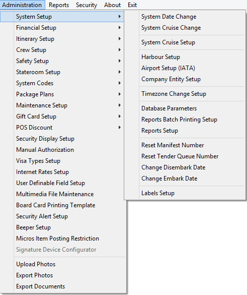

System Setup
In Administration, System Setup Menu, you can set up configurations such as Port of call, System Cruise, System Date Change, System Cruise Change, and Database Parameters.
Figure 9-1 Administration Menu
This figure shows the function in Administration Menu.

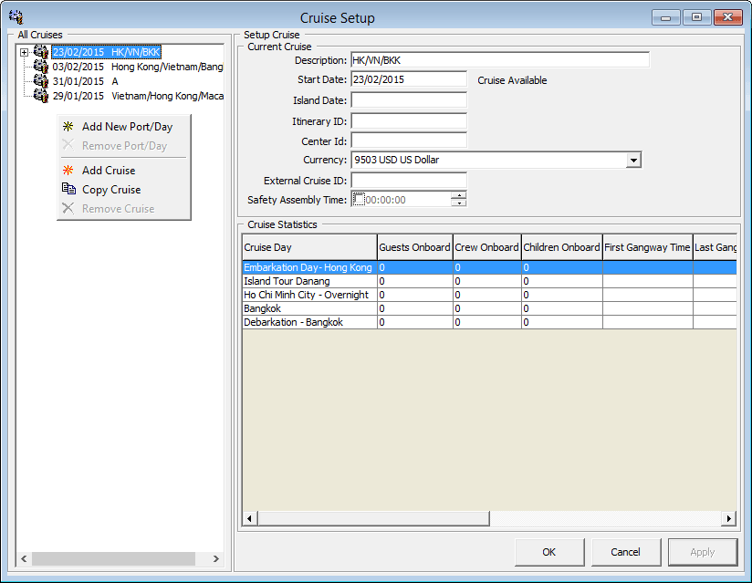

System Cruise Setup
Before the ship sets sail on its voyage, you must set up the start/end of the cruise in System Cruise Setup, detailing the start and end date, arrival/departure time at each port, and the base currency.
Figure 9-2 Cruise Setup
This figure shows the Cruise Setup for each cruise, the start date, base currency accepted.
Table 9-1 Cruise Setup Field Definition
Field Name Description
Description
Short code of the cruise. Mainly use to identify the cruise.
Start Date
The start date of the cruise.
Island Date
Special coded description for General Ledger (GL) Interface.
Itinerary ID
An identifier for the voyage/cruise.
Center ID
Special coded description for GL.
Currency
Official on board currency. See Financial Setup, Currencies
External Cruise ID
Cruise ID from an external party.
Safety Assembly Time
Schedule Safety Assembly Time for the cruise.
Creating System Cruise
  1. Select System Setup, then System Cruise Setup from the drop-down list.
  2. In the Cruise Setup window, right-click the All Cruises pane and select Add Cruise to open a blank setup form.
  3. Enter the Description, Start Date, Island Date, Itinerary and Currency.
  4. Click Apply to save.
Adding Port Day to Cruise
  1. At the All Cruises section of the Cruise Setup form, right-click on the Cruise Name and select Add New Port/Day.
  2. At the Setup Cruise form, enter the Date, Description, Port Comments, Weather and select from the drop-down list the Arrival Port, IPM Port Type, Arrival Country, Arrival Time and Departure Date/Time.
  3. Click Apply to save the form.
  4. Repeat the above steps for additional port day.
    You cannot alter the Port Day once the date is entered. You must first remove and re-enter the port day before adding the remaining port day.
Removing Port Day
  1. In the All Cruises pane, right-click the Port Date you wish to remove.
  2. Select the Remove Port/Day option.
    The system validates all reservations against the port day before a port/day or cruise is removed. If there are linked reservations found, amend the booking before proceeding.
Copying Cruise Day
The Copy Cruise function copies the same cruise setup/itineraries into a future date. If the information is completely different, we recommend that you create the cruise from scratch and add the port day individually.
  1. In the All Cruise section, select the Cruise Day, then right-click and select Copy Cruise.
    Figure 9-3 Duplicate Cruise
    This figure shows the Duplicate Cruise window which allow you to add the date you are duplicating to.
  2. Insert the Start Date and Description in the Duplicate Cruise window, then click Add. The copy cruise is not allowed if a Start Date exists.
  3. Click OK to confirm and populate the information in the All Cruises section.
Removing a Cruise
You can only remove a cruise when there are no reservation records attached to the cruise day. This option is dimmed when the system detects there is a link to a port day.
  1. In the All Cruises section, expand the Cruise Day container and select the port day to remove by right-clicking the date.
  2. Repeat the above step until all of the port days for that cruise are removed.
  3. Right-click on the Cruise Day and select Remove Cruise.
  4. Click OK to exit and return to System Cruise setup.

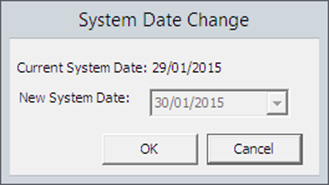

System Date Change
The Night Auditor or appointed user from the Finance Department is responsible for performing the System Date Change nightly. Before you run the System Date Change, all revenue centers must be in balance, and this includes the Point-of-Sale (POS) System, Cashbook, and other processes deemed necessary by the ship operator.
Performing System Date Change
  1. From the System Setup drop-down menu, select System Date Change.
    You are not allowed to proceed when the Cashier’s sessions is still active.
  2. At the System Date Change prompt, confirm the New System Date by clicking OK.
    Figure 9-4 System Date Change
    This figure shows the System Date Change prompt
  3. You will receive a warning message when the expected disembarking guest/crew remain as check-in in the system. Select Yes to proceed or No to return to the previous menu and resolve all pending check outs.
  4. When you select Yes, a progress window Closing pay period appears once the System Date Change commences. It only appears if the Payroll system is linked, and it changes all the pending reservation statuses for the date to No-Show.
  5. Once the System Date Change completes, you will receive an window indicating the new system date. Click OK to close the prompt.
    Cruise Statistics includes Guest Onboard, Visitor Onboard, Crew Onboard, and Children Onboard count will be displayed as well.

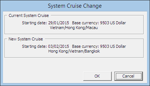

At the end of each cruise, all revenue centers and system accounts must be in balance and closed before you start a new cruise. This task is performed by the Chief Purser.
Performing System Cruise Change
Important:
The following process sets all accounts to Closed. All outstanding balances are carried forward to the next cruise. Proceed with caution.
  1. Select System Cruise Change.
  2. At the System Cruise Change prompt, click OK to confirm the New System Cruise.
    Figure 9-5 System Cruise Change
    This figure shows the System Cruise Change window, from Current System Cruise to the New System Cruise
  3. You will receive an Open Balance Warning if an unbalanced System Account is detected. Select Yes to proceed or No to return to the previous menu and resolve all pending check outs.
  4. Once the cruise change completes, the application returns to the Main menu.

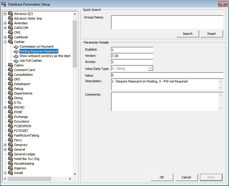

Database Parameters
The application is deployed with a set of Database Parameters that controls the operability and functionality of the module. These system parameters are grouped by module, followed by their function. Please consult Oracle Hospitality Cruise Customer Support prior to changing any of these parameters to avoid adverse implications.
Figure 9-6 Database Parameter
This figure shows the Database Parameters window
  1. From the System Setup menu, select Database Parameters.
  2. In the Database Parameters Setup window, click the plus (+) key to expand the group or navigate to the Quick Search section and search the parameter name in the Group/Name field and then click Search.
  3. Changing the value at the Parameter Details changes the behavior of the functions.
    1. Enabled: By default, all parameters are set to Enabled. In order to disable a parameter, change the value to 0 (0 = Disabled/ 1 = Enabled).
    2. Value: The acceptable value is defined in the description.
Defining the Days to Keep Log Files
You can to keep an activity log of certain functions, particularly the Interfaces. The number of days to keep is set up in Database Parameter:
  • Group Interface, Days to keep Log File.
  • Group Gangway, Gangway Log Days
Once defined, the system checks the log entries when the module starts and purges entries older than the days entered.

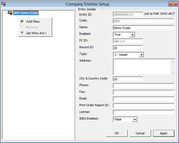

Company Entity
This function allows you to enter the company entity of the ship.
  1. From the System Setup menu, select Company Entity Setup.
  2. Right-click on the left pane of the form and select Add New.
  3. Enter all the information in the Entity Details section and then click Apply.
    Figure 9-7 Company Entities Setup
    This figure shows the Company Entities Setup window.
    Table 9-2 Field Definition of Company Entities Setup
    Entity ID
    Company Entity ID, provided by SPMS.
    Code
    Company or Ship Code.
    Name
    Company or Ship name.
    Enabled
    Set to True.
    Record ID
    Defines the record ID representing an entity.
    Type
    Type of Entity
    • 1 = Vessel/Ship
    • 2 = Headquarter
    • 3 = Warehouse
    Address
    Address of entity.
    City & Country Code
    Country of entity.
    Phone
    Phone.
    Fax
    Fax.
    Email
    Email address.
    Print Order Report ID
    Print Order Report ID used by Materials Management System (MM).
    License
    License Code provided by SPMS.
    IDEA Enabled
    Field use by MMS and is defaulted to False.
Assigning Company ID
  1. At the left pane of Company Entity Setup window, right-click the entity name and select Set Who Am I.
  2. At the confirmation prompt, select Yes to update information to Parameter Who Am I link.
  3. Restart the application for change to take effect.

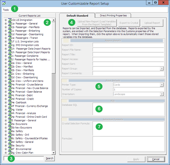

Reports Setup
The Report Setup function allows you to add customized Crystal reports to the existing System report set, or export the report template for use on another ship or for further customization.
Figure 9-9 Report Setup
This figure shows the configuration window to setup a report and its required parameters
Table 9-4 Setup Functions In Report
Figure Description
1
Tools function that uploads report templates from a public folder.
2
List of report sets available, including those manually uploaded.
3
Search function that enables you to search for a report.
4
Report detail of the report. For example, Report ID, User Access, Report Group.
5
Default printer configuration.
6
Formula embedded in the Crystal Report template.
7
Selection criterion input required from the user prior to generating a report.

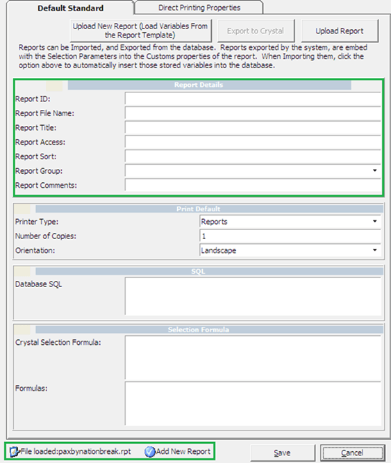

Adding New Report
  1. From the System Setup option, select Reports Setup.
  2. In the User Customizable Report Setup, Current Report List pane, right-click and select Add New Report to enable the fields on the right pane.
  3. Navigate to the right pane and select Upload New Report (Load Variables From the Report Template) or Upload Report.
  4. Search for the .RPT file on your local drive if you are uploading a report template.
  5. In the Report Details section, enter the following information:
    1. Report ID: Unique ID of customized report.
    2. Report File Name: Crystal Report file name, for example, pabxnationbreak.rpt.
    3. Report Title: Report name to show in Current Report List.
    4. Report Access: User Access Right to view/print report.
    5. Report Sort: Sort order of the report within the assigned report group.
    6. Report Group: Group this report belongs to. Select from the drop-down list.
    7. Report Comments: Additional comments/Information pertaining to this report.
    Figure 9-10 Default Standard for Report
    This figure shows the Default Standard tab you must fill up when creating a report.
  6. In the Print Default section, select the Printer Type, Number of Copies and the Print Orientation.
  7. Click Save to add the report to the list.
  8. Click OK at the Save New Report prompt. The newly added report name appears at the bottom of the screen
Removing a Report
  1. In the User Customizable Report Setup window, expand the Current Report List tree by clicking the plus (+) key.
  2. Right-click the report name you wish to remove and then select Remove Report.
  3. Click Yes when prompted.
Exporting a Report
  1. In the User Customizable Report Setup window, expand the Current Report List tree.
  2. Click the Export to Crystal button in the Default Standard tab.
