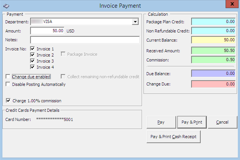

Pay Invoice
The Pay Invoice function is a settlement process against an invoice for part or full payment. As the Ship accepts various payment method, the process in applying these payments may vary.
Figure 10-56 Invoice Payment Window
Table 10-19 Field Definition of Invoice Payment Window
| Field | Description |
Department |
Financial Department codes - Credit. |
Amount |
Total amount due by guest, depending on the invoice no. selection. |
Notes |
Additional notes pertaining to this payment. |
Invoice Number |
Invoice number to apply the payment. |
Change due enabled |
Enable auto calculation of change due to guest. |
Disable Posting Automatically |
Disable postings being posted into the invoice. This sets the Posting Allowed to No in Guest Info tab. |
Charge 1% Commission |
Credit Card commission charge. Amount auto populates in Commission field when checked. |
Credit Cards Payment Details |
Displays masked credit card number assigned to this invoice. |
Package Plan Credit |
Eligible credit value for Package Plan posting. |
Non Refundable Credit |
Credit value non-refundable to the guest. |
Current Balance |
Current Invoice Balance. |
Received Amount |
Amount received. |
Commission |
Applicable credit card/foreign exchange commission value. Calculate when Charge 1% Commission is ticked or when the foreign exchange has commission defined. |
Due Balance |
Outstanding sum after deducting payment applied. |
Change Due |
Balance due to guest when payment applied is more than invoice value. |
Pay |
Apply payment receipted and does not print cash receipt. |
Pay & Print |
Apply payment receipted and print invoice at the same time. |
Pay & Print Cash Receipt |
Apply payment receipted and print cash receipt at the same time. |
