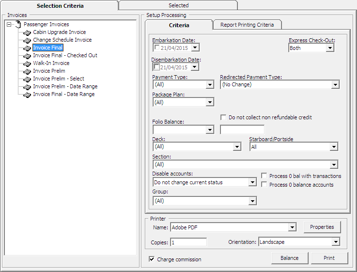

Quick Billing
The Quick Billing function is designed to expedite the check-out process during disembarkation, and enable invoices to be printed in batches using a filter. This function is accessible from File Menu, Cashier, Guest Quick Billing.
Figure 10-146 Quick Balance Selection Criteria
Table 10-36 Quick Balance Selection Criteria
| Field | Description |
Passenger Invoices |
Type of invoice form. |
Embarkation Date |
Embarkation Date filter. |
Disembarkation Date |
Disembarkation Date filter. |
Express Check Out |
Select to include/exclude in Express Check-Out. |
Payment Type |
Payment type filter. |
Redirected Payment Type |
Redirect selected payment to another payment method. |
Package Plan |
Filter by Package Plan. |
Folio Balance |
Filter by folio balance, for example: greater than or equal to X value. |
Do not collect non-refundable credit |
Credit balance withheld for use in future cruise. |
Deck |
Invoice sort order by deck. |
Starboard/Portside |
Invoice sort order Starboard/Portside. |
Section |
Invoice sort order by section. |
Disable accounts |
Update account status to "allow manual postings only" or "blocked all postings" |
Process 0 bal with transactions |
Include guests that have already settled in full and allow a reprint of the invoice in Quick Billing window. |
Process 0 balance accounts |
Include 0 balance accounts with/without transactions. |
Group |
To include Group Account. |
Printer |
Printer assigned for invoice printing, number of copies to print and print orientation. |
Charge Commission |
Define whether applicable commission applies when balancing the accounts. |

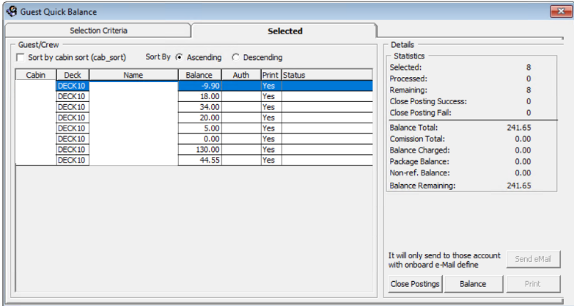

Figure 10-147 Quick Balance Selected Tab
Table 10-37 Field Definition of Guest Quick Balance
Cabin |
Cabin number. |
Deck |
Location of Cabin. |
Name |
Guest Name. |
Balance |
Total Invoice Balance. |
Auth |
Authorization Status. |
Invoice Printed status. |
Status |
Close Posting status or Invalid Address validated during Balance process. |
Statistics |
Indicator count of selected, processed, and remaining accounts and close posting - successful/fail with its value is in balance or charged. |
Send eMail |
Invoices are emailed to guest on-board email account. |
Close Postings |
Set invoice postings to close. |
Balance |
Process balancing for selected accounts. |
Print invoices for selected accounts. |
