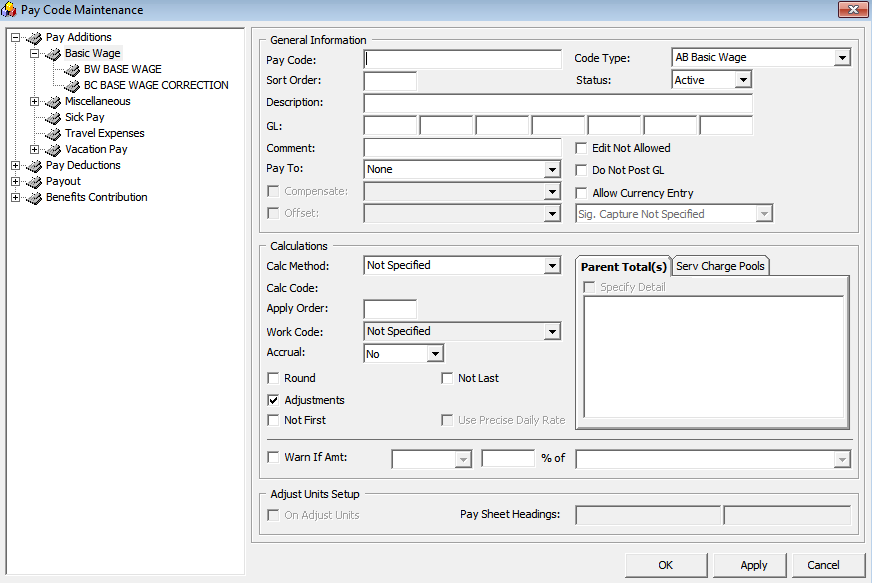

Creating a Code Type
  1. Log in to the Payroll module.
  2. Navigate to the Maintenance menu and select Pay Codes from the context menu.
  3. On the Pay Code Maintenance window, right-click and select Add Pay Code Type.
  4. Enter a short code and description in the Description field.
    The first character of the Code Type determines the type of pay calculation to use. A Pay Additions Code Type MUST begin with an A, Deductions with a D, Pay Outs with a P and Benefit Contribution with a B. Otherwise the system will not calculate the pay correctly.
  5. Enter additional information in the Comment field, if any.
  6. Check the Enabled checkbox to enable/disable the display of pay code types in other setup forms such as crew assignment, contract template and others.
  7. To delete a selected pay code, right-click and select Delete Pay Code Type.
Figure 26-1 Pay Code Maintenance
The figure shows the Pay code Maintenance window.
Table 26-1 Pay Code Maintenance Field Definition
Field Description
Pay Code
A unique identifier for the pay code. Usually a number, but can be alphanumeric.
Code Type
The type and group of this pay code.
Sort Order
User definable sort order. If no additional sort is required, enter a zero (0) in this field.
Status
The current status of the pay code (Active or Inactive).
Description
The name of the pay code.
GL
The general ledger account number of the pay code.
Comment
Any additional information for this pay code.
Pay To
Determines if the pay code requires information on where to send the deduction or payment.
  • None: No Pay To is required.
  • Specify: Pay To information will be requested at contract time for this pay code.
Compensate
Works with code type, Benefit Contribution – BCC & BUP to populate pay deduction as the deduction of payroll for crew contributions to pension plan or medical plan.
Offset
Work with code type, Benefit Contribution to populate the benefit contribution pay code as the benefit posting to the balance automatically when payroll is paid out at the end of the pay period.
Edit Not Allowed
An option that disables the user from being able to modify the pay amount of the pay code while editing the contract or assignment.
Do Not Post GL
The option to not write the pay code into the GL file when generating a GL file.
Allow Currency Entry
A function to allow entry of currency conversion when adding posting or payroll adjustments.
Note: Applicable to Quick Posting, New Pay Item, Cash Advance, and Payout.
Signature Capture
A signature capture is required during payout. Only applicable when selecting Payout.
Calc Method
This code determines the calculation method used to calculate the amount of the pay code.
Calc Code
Works with Calculation Method ‘A-SPEC’,’D-SPEC’ or ‘P-SPEC’. It represents a special calculation method that was added to the program to handle a calculation outside the normal methods.
Apply Order
The posting order of the pay codes when calculating the pay. The order is within the Additions, Deductions and Pay Out pay groups.
Note: If a pay code is to be based on a previously calculated amount, then that amount must have a lower apply order of the pay code set up so that its value will be available for the calculation.
Work Code
Works with the Time Attendance calculation method A-TAOT, A-TAHO, A-TANO, A-PPPH.
Accrual
Amount accrued for the next month.
  • Yes: Amount calculated for this pay code is accrued to the next period at pay out until the end of the crew’s contract is reached.
  • No: Amount not accrued to next month.
  • Background: The amount calculated for this pay code is accrued to the next period but is hidden on the pay sheet. It shows the total accrued amount on the pay sheet only and is paid out when the person’s contract is reached.
Note: Only Pay Additions and Pay Outs can be accrued.
Parent Total
For certain Calculation Methods (Percent of another amount for example), you can specify the percentage to include on previously calculated pay codes
For example: The new Pay Code “10% Percent Bonus” is a percentage of the person’s Basic Wage and Leave Pay.
Note: The apply order field for the new pay code must be greater than the apply order field for any of the amount to be used in the calculation. When this button is selected, a list box appears, allowing you to pick the pay codes.
Service Charges Pool
Works with the Service Charge calculation method A-HBSC to populate the service charge pool type.
Use Precise Daily Rate
Uses a more precise formula to calculate monthly pay.
Example: 10% of Monthly Wage $2100
Used with Precise Daily Rate: 10% x (2100 *12/365) * 29 (contract day) = $200.22
Without Use Precise Daily Rate: 10% x (2100/30) * 29 (contract day) = $203
Note: This option is enabled when the pay code is selected at Specify Detail. It is used more on the A-PERC calculation method.
Round
Round the final amount calculated for this pay code to the nearest denomination unit of currency.
Adjustments
Option to allow the pay code for manual adjustments.
Note: Applicable to Add New Pay Item, Quick Posting, and Cash Advanced.
Not First
Do not use this pay code for the first pay period of the contract.
Not Last
Do not use this pay code for the last pay period of the contract.
Warn if Amt
This restricts the amount entered on one (1) pay code based on the amounts entered for another pay code.
For example: If an allocation must be at least 80% of a crew member’s base pay, you would check the Warn If checkbox, select “is less than” from the drop-down list, enter 80 in the percent text field and select “Base Pay”.
Adjust Unit Setup
Determines whether this pay code appears on a person’s pay sheet so that unit information can be entered.
Pay Sheet Headings: The descriptions to display at the top of the Pay Sheets for Multiple People form.
Note: Apply to calculation methods assigned to ‘PPER, HOUR, PDAY, SPEC, PDTD, PDTI, PPMW, PPTE, PWEK, PYER, VACP, TAHO, TANO and TAOT’.
Adding a Pay Code to Code Type
  1. On the Maintenance, Pay Code Maintenance window, expand the tree view and right-click the Code Type you wish to add to the pay code.
  2. Select Add Pay Code and complete the pay code setup form.
  3. Click Apply to save or click OK to save and exit the form.
  4. To edit, select the Pay code, edit and then click Apply to save the changes.
    WARNING:
    Please use extreme caution when updating pay codes since many of the codes are dependent on other codes.
    • Changing the Apply Order or the calculation method of the code may have an adverse impact on another code.
    • Changing the Calculation Method of an existing pay code from “Flat Rate” to “Percent of Another Amount” will not affect the pay code that is already added to an assignment.
Deleting a Pay Code
To delete a pay code, right-click the code and select Remove. You can only delete an unused pay code.

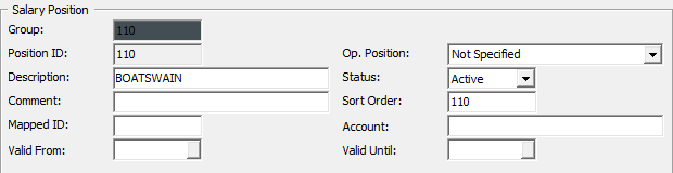

Salary Position
Salary Position groups people by its job responsibilities within a Salary Group. These groups of people typically have a similar, if not identical contract.
A set of salary positions is maintained for the entire Payroll system and is used by all companies set up in the system.
Creating Salary Position
  1. Select the Salary Position from the Payroll Maintenance menu option.
  2. A list of Salary Groups is shown in the Salary Position Maintenance window. Click the plus (+) key to expand the view of existing Salary Positions.
  3. Right-click the Salary Group and select Add New to create a new position.
  4. Enter all the require information and click Apply to save. Refer to the following table for field descriptions.
Figure 26-2 Salary Position
This figure shows the Salary Positions
Table 26-2 Salary Position Field Definition
Field Description
Group ID
Field represents the Group ID of the Salary Group. This is generated automatically based on the selected Salary Group.
Position ID
Unique ID for Salary Position.
Description
Position name.
Comment
Additional comments.
Mapped ID
GL mapping field used in the GL Output field.
Valid From/Until
Validity Period for the position. If the field is blank, this means the position does not have a Validity date.
The program checks the valid date against the current system date. An expired or invalid position is not shown when creating a crew contract/assignment.
Op. Position
Links the Salary Position to Operational Department. Once the position is linked, the crew member that belongs to the operational position is populated on the crew assignment screen.
Status
Active/Inactive. If the status is set to Inactive, the salary position is not displayed when creating a crew contract.
Sort Order
Sort Position by the order entered. Used as an alternative sort. If alternative sort order is not required, you may enter any number in this field.
Account
Department name used for the GL output field.

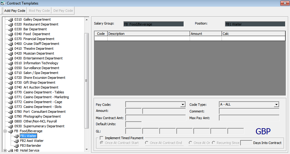

Contract Template
The Contract Template allows you to define a basic contract template for each Salary Position, by person or company specific. This can be used as initial contract pay codes when adding a contract.
Figure 26-3 Contract Templates Form
The figure shows the Contract Templates form.

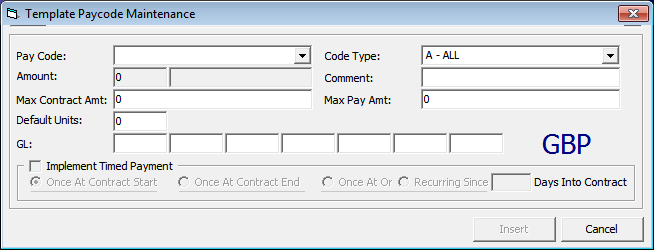

Adding Pay code to Contract Template
  1. Select a Position on the Contract Template form.
  2. Click Add Pay Code.
  3. Navigate to the Template Pay code Maintenance form and fill in the details accordingly.
  4. Click Insert to save.
Figure 26-4 Template Pay code Maintenance
The figure shows the Pay code Maintenance template.
Table 26-4 Template Pay code Maintenance Field Definition
Field Description
Pay Code
Pay code Selection
Code Type
Filter for the pay code by Code Type.
Amount / Rate
Amount of pay code.
Note: Shows ‘Flat Amount’ when calculation method defined is amount calculation. Shows ‘Rate / Percentage’ when calculation method defined is percentage calculation.
Comment
Pay code comments in template.
Max Contract Amount
This field holds the total amount (in payroll currency units) that this pay code can accumulate to for the entire length of the contract. Once this amount is reached, no additional amounts are computed for this pay code.
GL
The shore side general ledger account which this pay code will be accounted for.
Note: Will be auto populated if GL codes have been defined in Pay code setup.
Implement Time Payment
Pay code used for payable upon return. There are four (4) categories:
  • Once At Contract Start: Pay code only applies one time upon contract start.
  • Once At Contract End: Pay code only applies one time upon contract end.
  • Once At: Pay code only applies after X days specified in Contract.
  • Recurring Since: Pay code amount recurs on the next pay period since X days specified in Contract.
Note: This option only applies to Pay Additions and Pay Deductions.
Creating Contract Template
  1. Go to the Maintenance, Contract Templates menu. A list of all salary groups is displayed.
  2. Expand the group by clicking the plus (+) key.
  3. Click Add Pay Code.
  4. On the Add Pay code form, enter the pay amount and necessary details.
  5. Click Insert to insert a pay code into the template.
  6. To modify a pay code of a template, select the pay code and click Mod Pay Code.
  7. Update the details and then click Update to save the changes.
  8. To remove a pay code from the template, select the pay code and click Delete Pay Code.
  9. On the confirmation prompt, click OK to proceed.

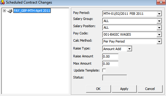

Schedule Contract Changes
Schedule Contract Changes is a scheduler that changes the pay code rates and amount for the following pay period, and can only set up a schedule for future pay periods. For instance, you would set up a schedule in March for a change to take effect in April. The changed pay rate is applied when a new pay period is activated and maintained by the company.
Figure 26-5 Schedule Contract Changes
The figure shows the Schedule Contract Changes window.
Table 26-5 Schedule Contract Changes Field Definition
Field Description
Pay Period
Effective Pay Period for the raise.
Salary Group
Department to which the raise applies.
Salary Position
Position entitled to the raise.
Pay Code
Pay code for which the raise applies.
Raise Type
Defines the type of raise.
  • Amount Add: Add the raise amount to the current rate/amount for that pay code.
  • Percent Add: Adjust the rate or amount by percent
  • From – To: Change the pay only for specified old amount to the specified new amount
  • Change To: Change the rates or amounts to the raise amount.
Raise Amount
Value of raise
Max Amount
Maximum raise amount
Update Template
If the Update Template field is selected, the contract template updates with the raise upon opening the specified month.
For example: Selected when the raise applies to the existing contract template(s) for the selected salary group, position and pay code.
Status
Status of schedule changes. Show ‘Closed’ when changes are being processed.
  1. On the Maintenance menu, select Schedule Contract Changes.
  2. On the Schedule Contract Changes form, right-click and select Add.
  3. Complete the setup form and click Apply to keep the form or click OK to save and close the form.
  4. To remove the schedule, right-click the selected schedule and click Remove. You are not allowed to remove a processed schedule.

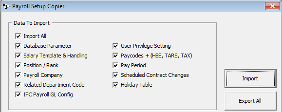

Payroll Setup Copier
  • The Payroll Setup Copier is a tool that copies the entire payroll setup from one database to another, excluding these set ups:
  • Cost Center
  • Daily Currency Setup Detail
  • Operation Position (SPO_AID_ID will be null)
While importing the data into the destination database, the Payroll Setup Copier checks the following:
  • Unique record in Pay Raise table, or else the following message appears.
Figure 26-7 Payroll Setup Copier Unique Record Prompt
The figure shows the Payroll Setup Copier Unique Record Prompt.
  • Tax name must be unique, or else the following message appears.
    Figure 26-8 Payroll Setup Copier Unique Tax Name Prompt
    The figure shows the Payroll Setup Copier Unique Tax Name Prompt.
  • When importing from a selected Payroll Company, all related loyalty bonuses and the vacation pay matrix are copied over, as well as inserting new records but will not delete the existing setup.
  • When importing a Salary Template & Handling and both the source ship and target ship have a loyalty bonus and vacation pay matrix set up, the existing setup of the target ship is deleted before the import continues.
  • If the target ship has a parent total linking or an operation position is unlinked on a source ship that has linking, the Import re-inserts the link.
Figure 26-9 Payroll Setup Copier Options
The figure shows the Payroll Setup Copier Options.
  1. On the Maintenance menu, select Payroll Setup Copier.
  2. The application disregards all checked items for the export function. Click Export All when ready.
  3. On the Browse for Folder window, select the location to save the file, and then click OK.
  4. When the export completes successfully, the system automatically saves the Extensible Markup Language (XML) file (PYRL_SETUP_v[version_number]) at the selected location and displays a confirmation box. Click OK to close the prompt.
  5. To import the data, login to the Payroll module of the destination database.
  6. On the Maintenance menu, select Payroll Setup Copier.
  7. On the Payroll Setup Copier window, select the respective checkboxes for the data to be imported and click Import.
  8. Select the file to import from the saved location.
  9. Once the import process starts, a progress bar is shown.
  10. At the end of the process, the system displays a confirmation prompt. Click OK to close the prompt.
