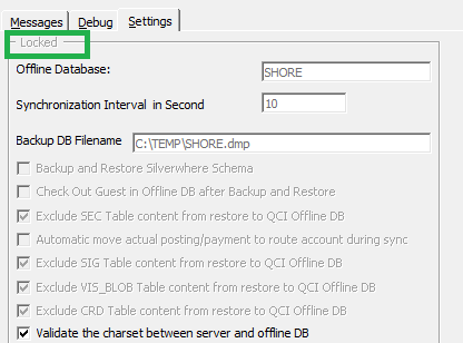

Synchronization Process for DB using TDE
The synchronization process for a database that uses TDE are lesser than the standard process, and are listed in below table.
Figure 2-11 QCI Synchronization DB Locked

Process 13 |
The system disables all parameters in the Settings tab and a dimmed 'Locked' is shown on the window when the Offline Mode is ready. |
