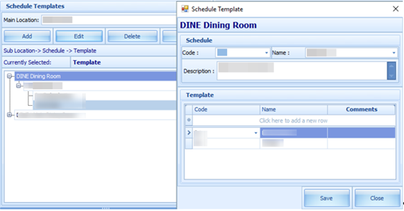

Before you can schedule task(s) to a crew and to ease future scheduling, we recommend that you create a schedule template for each sub-location.
Schedule Templates
Figure 8-4 Schedule Templates
This figure shows the Schedule Templates form.
  1. In the Roster Setup window, select Roster Template & Scheduling.
  2. In the Schedule Templates section, select the Main Location from the drop-down list.
  3. Click Add to open the Schedule Template window.
  4. In the Schedule section, insert the Code, Name, and Description.
  5. In the Template section, click the blank space under the header to add the schedule cruise day by inserting the Code, Name, and Comments.
  6. Click Save to create the cruise type and days.
  7. To edit the cruise day/type, select the line item and click the Edit button.

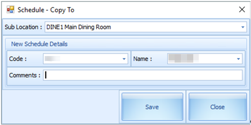

Copying Cruise Type by Sub-Location
Figure 8-5 Copy Cruise Schedule
This figure shows the Schedule-Copy To window.
  1. Select the Cruise Type and click the Copy button.
  2. In the Schedule-Copy To window, select the destination Sub-Location, Code, and Name from the drop-down list.
  3. Click Save to complete the process.

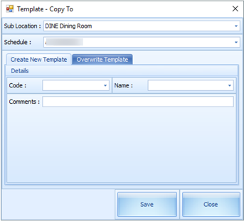

Overwrite Template of the Same Schedule
  1. Select a Cruise day to copy and click the Copy button.
  2. In the Template-Copy To window, select the Sub-Location and Schedule from the drop-down list.
  3. Navigate to the Overwrite Template tab, select an existing cruise day to overwrite, and click Save.

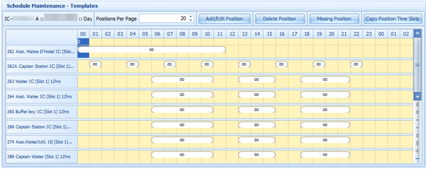

Schedule Maintenance Templates
Figure 8-7 Schedule Maintenance Template
This figure shows the Schedule Maintenance Template
  1. Select a cruise day from Schedule Templates, then click the Add/Edit Position button.
  2. In the Schedule Maintenance window, select the Position and then the Slot from the drop-down list, and Team, if any. You can also add a slot by selecting a Position. To insert a required slot, click Add Slot and click Save.
  3. The slot number is unique for each position and there are 26 available slots.
  4. Click Save and Close to exit.
  5. Each of the crew member should have an individual slot for the position. For example, if the position of Assistant Cook requires 10 crew members to be on duty, then 10 slots must be created for this position.
  6. Click the Save button in Schedule Maintenance window to assign the position(s) for the cruise day. The defined positions will populate in the grid as shown in Figure 8-7.

Creating Time Slots for Position
  1. In the Schedule Maintenance-Templates grid, select the required time slots for the position, and right-click to display the options or double-click the grid to open the Time Slot window.
  2. Select a Roster Task Code and enter the Start/End Time.
  3. Click the OK button to save the time slot. The time slots saved are reflected in the grid.

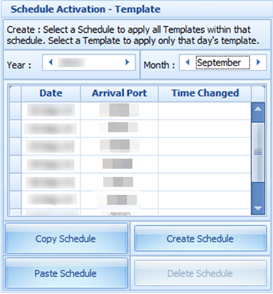

Schedule Activation Template
The Schedule Activation Template enables you to assign a schedule template to the days listed of the selected the month.
Figure 8-8 Schedule Activation Template
This figure shows the Schedule Activation Template in Roster Setup where you can create, copy or paste a schedule.
Creating Schedules by Cruise Type
  1. Select the Cruise type from the Schedule Template section.
  2. Select the start date from Schedule Activation-Template and then click Create Schedule. For example, the cruise type has eight cruise days and by selecting 01 April 2017 as a start date for the schedules, it then creates 01 April 2017 as cruise day one, 02 April 2017 as cruise day two, 03 April 2017 as cruise day three and so on.
  3. At the confirmation prompt, read the statement before proceeding. Click Yes to remove the existing schedule from the date(s). The list of the crew with schedules is listed under the Scheduled section. The Crew Schedule creates the checked-in status by crew first, sorted by name, and followed by the crew with expected status.
Creating Schedule by Cruise Day
  1. At the Schedule Activation-Template section, select the date and click Create Schedule.
  2. At the confirmation prompt, click Yes to create the cruise day schedule. After the schedule is created, a list of crew created with the schedules is listed in the Scheduled section.
    This will remove existing schedule, if any.
