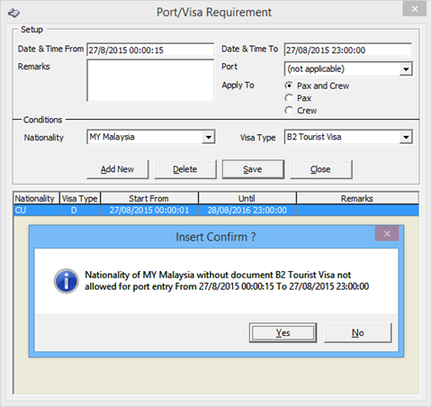

Port/Visa Requirement
You can restrict crew members who have travel restrictions on their travel documents from going ashore on port day. Once set up, the system prompts a notification window when a restricted crew member’s passport/travel document is swiped at the Gangway.
Figure 7-131 Port/Visa Requirement
This figure shows the Port/Visa Requirement
  1. From the Security menu, select Port/Visa Requirement.
  2. Click Add New, enter the Date/Time From/To field, and select the Port from the drop-down list.
  3. At the Conditions Setup section, select the Nationality and Visa Type from the drop-down list. and click Save.
  4. At the Insert Confirmation prompt, select Yes to confirm, and click Close to exit.
