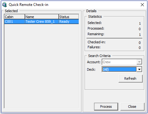

The Quick Remote Check-In enables you to check-in the crew by Deck.
Figure 7-28 Quick Remote Check-In
This figure shows the Quick Remote Check-In
  1. From the Quick Functions options menu, select Quick Remote Check-In option.
  2. Select the Deck from the drop-down list and click Refresh.
  3. At the Selected Crew section, cabin number and name of crews due to check in are listed, with the total selected account shown at the Statistic section.
  4. Click Process and select Yes at the confirmation prompt to proceed.
  5. The system updates the number of records processed and its status in the Statistic section. Click Close to return to the main window.
