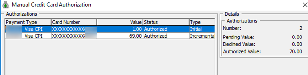

  3. Navigate to the Credit Card tab in the guest account. The registered card should be in Active mode.
  4. To display the authorization, select the credit card and click View Authorization.
Figure 3-1 Authorization Screen
This figure shows the Authorization Screen

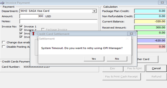

Figure 3-2 System Timeout
This figure shows the System Timeout
For Online Settlement parameter = 0:
The system follows the above 'Yes' logic. When the SPMS client is not able to connect to OPI API or Daemon, the system deletes the POS record so that the invoice is not 0.

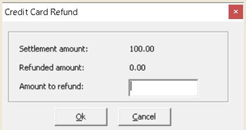

  3. Under the Invoice tab, click the Credit Card Refund button. This launches the Credit Card Refund window, showing the Settlement amount, Refunded amount, and Amount to refund.
    • Settlement Amount: The selected settlement amount
    • Refunded Amount: Total refunded amount for the selected settlement
    • Amount To Refund: User input amount to refund
    Figure 3-3 Credit Card Refund window
    This figure shows the Credit Card Refund window.
  4. Insert the value in Amount to refund and click OK button to proceed. The sum of the Refunded amount and Amount to refund must not exceed the Settlement amount.
