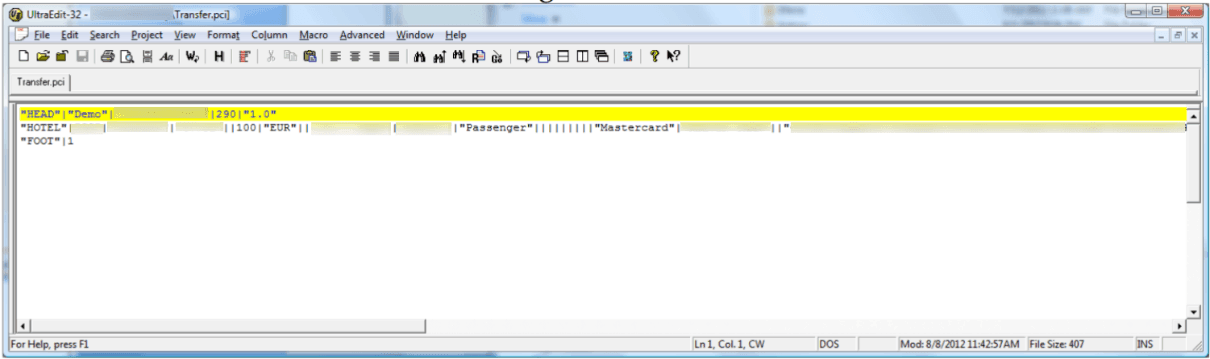

Credit Card registered with Test Authorization has status Outstanding or Declined. The system prompts ‘‘There is Test Authorization without response or declined response’
Click the Process button to generate the Initial Authorization file. After the incremental authorization file is created, the screen displays the location of the saved file. A sample of the incremental file is illustrated in Figure 1‑10 - Sample Authorization File
Figure 1-1 Sample Authorization File

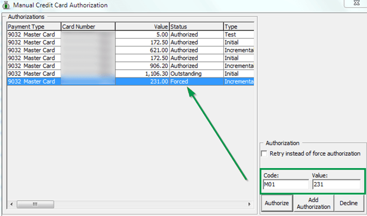

Obtaining Manual Authorization
In the Management module, Guest Handling function, select the guest account.
Navigate to the Credit Card tab and click View Authorization.
In the Authorization screen, select Add Authorization.
Enter the value including the initial authorized value in the Credit Card Authorization screen when prompted and click OK to save.
An additional authorization is added to the Authorization grid with its status shown as Outstanding. Select the line item from the grid, enter the code and value obtained, and then click Authorized. This process overwrites the existing value and changes the authorization status to Forced, and writes the authorization code into the Settlement file as the last authorization code.
Figure 1-2 Management — Manual Authorization
