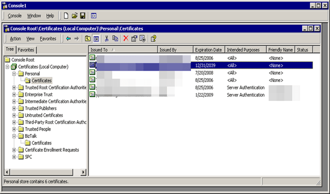

When opening the MMC for “Local Computer” certificates, you should see something similar to Figure 1–1 Console Root Window below. Notice the Certificates (Local Computer) / Personal / Certificates is showing the new certificate.
Figure 1-1 Console Root Window
This figure shows the Console Root Window
When opening up the details of the certificate, you can see at the bottom, “You have a private key that corresponds to this certificate.” This means the OS Key Container public/private keypair is associated with the certificate in the Certificate Store, and you can decrypt items as they come into this “BizTalk” Node.

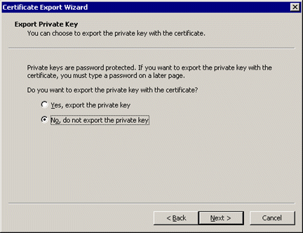

  3. Within the wizard, select NO Do not export the private key, and click Next
    Figure 1-2 Certificate Export Wizard —Export Private Key
    This figure shows the Certificate Export Wizard — Export Private Key

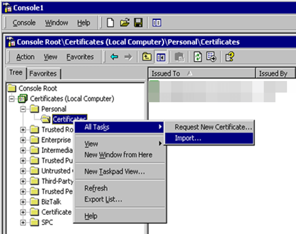

  1. Copy the PFX file to the node you are working on
  2. Right click the Personal, Certificates folder, select All Tasks, and then select Import

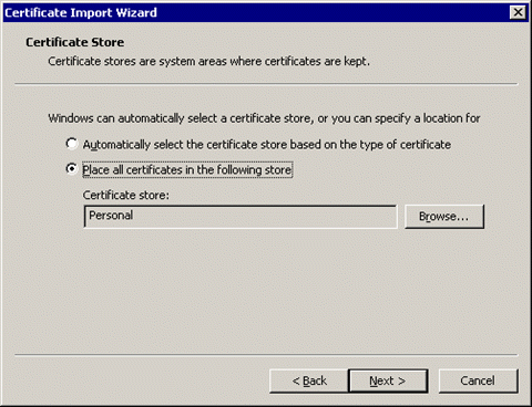

  3. When specifying the file to import, change the “Files of Type” to “Personal Information Exchange (*.pfx, *.p12)” and select the “BizTalk Shipboard xx.pfx” file
  4. When prompted, enter the password and do not select Mark this key as exportable. This is to prevent the key from being exported and used elsewhere
  5. Select the option Place all certificates in the following store and use the default Personal store.
    Figure 1-5 Certificate Import Wizard — Certificate Store
    This figure shows the Certificate Import Wizard — Certificate Store
