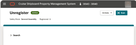

To access the Unregister menu,
  1. From the Menu, click Mustering, Unregister.
    Figure 2-11 Unregister Page
    This figure shows the Unregister Page
  2. You will be redirected to the Unregister page where the Safety Mode appear at the top of the page.
Begin Unregister

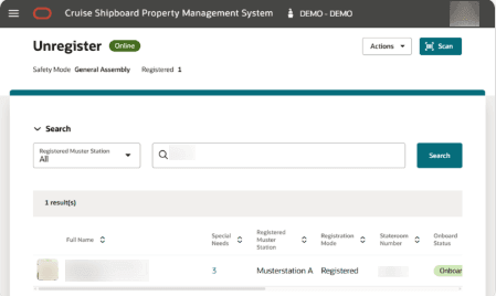

Manual Profile Search
  1. Click the Muster Station/Lifeboat, and enter either First Name, Last Name, Stateroom Number, Manning Number, Board Card Number, External Board Card Number or Contactless ID in the search bar.
  2. Click the Search button. All the matching records are shown in the results view.
  3. Select a record.
  4. The system shows a confirmation message:
    • Select Unregister to continue. Once the un-registration completes, whether it is a success or failure, it will show a card view before reverting to the default view.
    • Select Cancel to terminate. The system navigates back to the search result.

Figure 2-12 Unregister Page for Search Profile
This figure shows the Unregister Page for Search Profile
The search results presented varies depending on the parameter value in General - Use Resident. If the value is set to 1, the resident count is included in the result(s).
