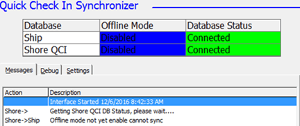

  1. At the QCI Sync Interface PC, run the QCI Sync application.
  2. Ensure both the ship and QCI Shore database status are as follow:
    • Database Status is 'Connected'
    • Offline Mode is 'Disabled'
    • Messages shows 'Offline mode not yet enable cannot sync'
    Figure 2-9 QCI Sync Offline Mode
    This figure shows the database connection in an Offline Mode.
    When the Ship or Shore QCI Database Offline Mode status shows Enabled, then the database mode must be stopped first, before clicking the Start Offline Mode Procedure. Otherwise, the system prompts an error message Please stop the Offline Mode first before continue.
    To stop the database mode, click the Stop Offline Mode of the Settings tab to refresh the Shore Database to a clean state.
