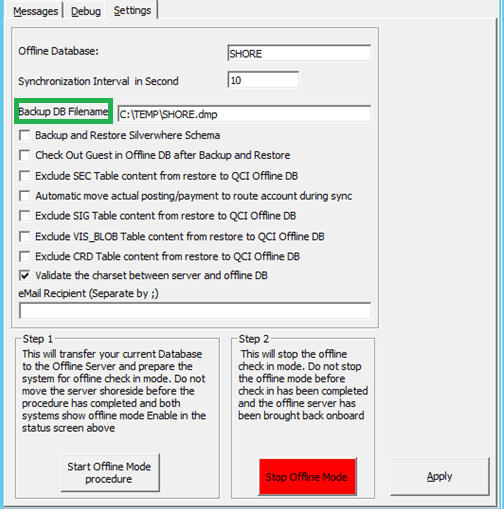

Configuring the Interface
This section describes the settings available in the interface Settings tab. To configure the interface, start the QCI Sync Interface, select the appropriate checkboxes at the Settings tab, and then click Apply to save the changes.
These settings are saved to the OHCSettings.par file in C:\Public Document\Oracle Hospitality Cruise folder
Figure 2-7 QCI Sync Interface Settings
This figure shows the configuration settings in QCI Sync Interface.

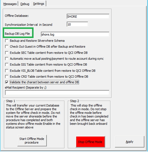

Figure 2-8 QCI Sync Interface Setting —TDE
This figure shows the configuration settings in QCI Sync Interface if TDE is used.
Table 2-3 QCI Sync Interface Settings
Parameter Description
Offline Database
Defines the SID of the QCI Shore database. It must be identical to the one created in Oracle Net Manager.
Synchronization Interval in Second
Defines the interval time to before the synchronization between the ship and QCI Shore Database starts in x seconds. The default value is ten (10) seconds.
Backup DB Filename
Defines the ship database backup file name. The same backup file is used for both the backup and restores processes. The user must define the full path of the name where the backup file resides and the file name extension must be .dmp. For example, C:\Shipname.dmp.
If TDE is used, the field name changes to Backup DB Log File. You should provide only the file name excluding the full path, for example; backup. This file name will be used as the data import log file.
Backup and Restore SilverWhere Schema
Enables the interface to backup and restore the SilverWhere dining schema (BKSTG_DINING) from the ship database to the QCI Shore database and enable passenger's board card to be printed with dining details. The SilverWhere dining schema is imported once and no update is required from the ship to the QCI Shore Database.
Check Out Guest in Offline DB after Backup and Restore
Enables the interface to automatically check out all previous cruise passenger's reservations in the QCI Shore database, due to the backup and restore process that was not performed before the actual embarkation day. For example, user enabled the QCI Sync Interface using the last backup and restore.
Exclude SEC Table content from restore to QCI Offline DB
Excludes the pictures from the ship to the QCI Shore database when restoring from the backup and restore process. If this feature is checked, the time taken to backup and restore will take longer.
Automatic move actual posting/payment to route account during sync
Enables the interface to move actual posting and payment automatically to routed account when the Offline server is synched. The process commences after the database synchronization completes.
Exclude SIG Table content from restore to QCI Offline DB
Excludes the credit card signature captured when restoring from ship to QCI Shore database during the backup and restore process. If this is checked, the time taken to backup and restore will take longer .
Exclude VIS_BLOB Table content from restore to QCI Offline DB
Excludes the Travel Document image when restoring from ship to QCI Shore database during the backup and restore process. If this feature is checked, the time taken to backup and restore will take longer.
Exclude CRD Table content from restore to QCI Offline DB
Excludes the credit card records when restoring data from ship to QCI Shore database during backup and restore process. In the Guest Info window, the payment method will show as 'Credit Card' without the card details to comply with the Payment Card Industry (PCI) standards.
Validate the charset between server and offline DB
Verifies both the ship and Shore Database to ensure it has the same Charset before you are allowed to proceed. The system prompts this message "Ship DB charset is xxx – shore DB charset is xxx. They do not match. Please inform Oracle Hospitality Cruise support so these can be adjusted. This is an informational message only and will not impact your current sync process.".
eMail Recipient
Defines the system administrator's email address for notification to be sent when an error occurs during the synchronization process. The notification email is sent after every third synchronization. This requires an email server to be setup in the Administration module, Parameter, Promo, SMTP Server IP Address.
