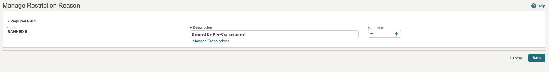

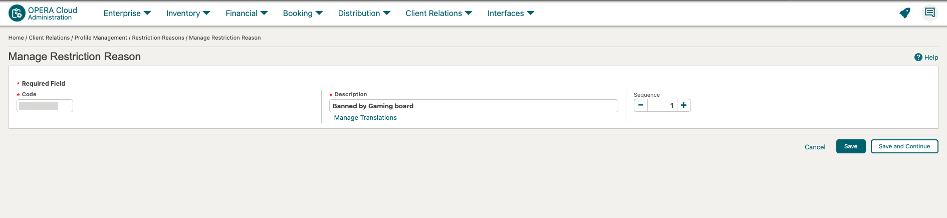

in OPERA Cloud. Since the Restriction Reason Code in OPERA Cloud is limited to 8
characters, it will be truncated. However, you must still enter the same code, or it
will not appear in the edit profile section.
If you need details on how to configure Restriction Reasons, see OPERA Cloud online documentation.
You can use the below details to create Restriction Reasons.
- Code: Add the same code as the external system.
- Description: Add the same description from the external system.
