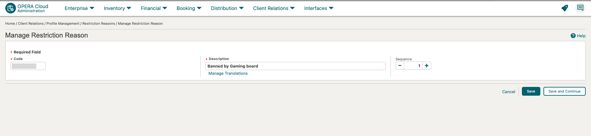

This image shows how to configure Restriction Reasons.
If you need details on how to configure Restriction Reasons, see Configuring Restriction Reasons.

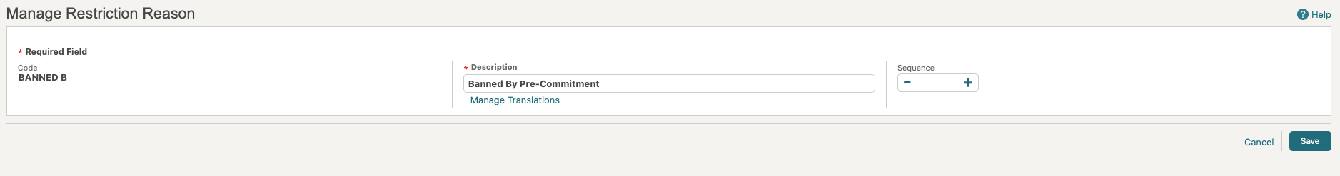

You can use the below details to create Restriction Reasons.
  • Code: Add the same code as the external system.
  • Description: Add the same description from the external system.
This image shows how to create Restriction Reasons.
