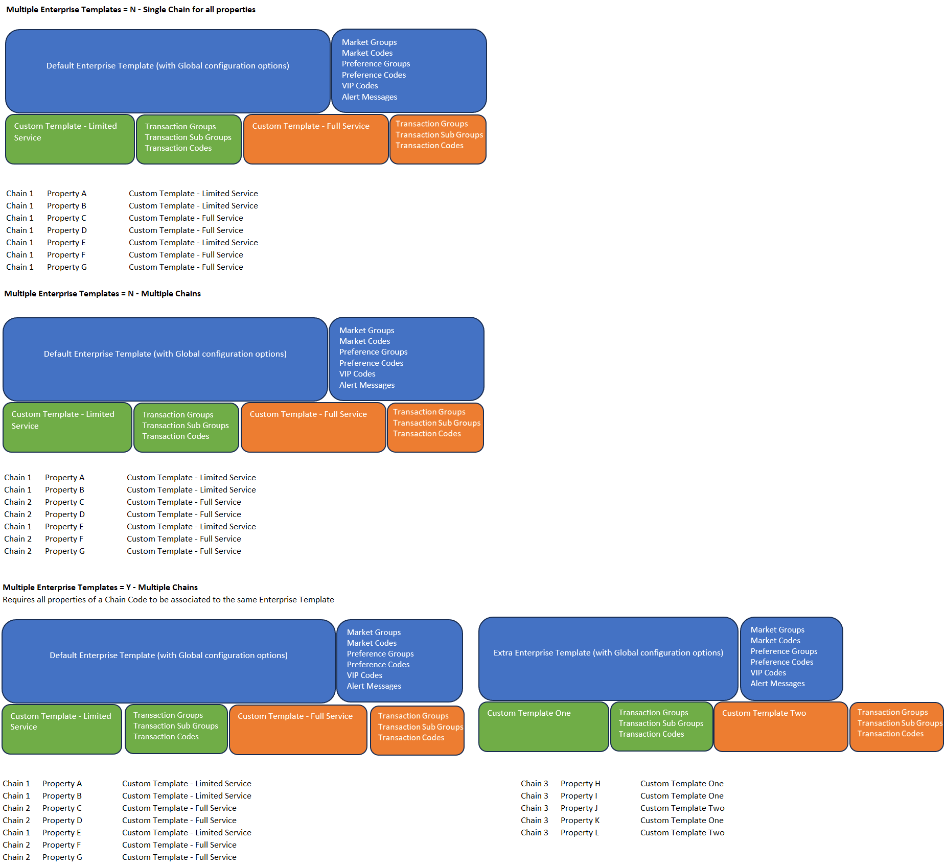

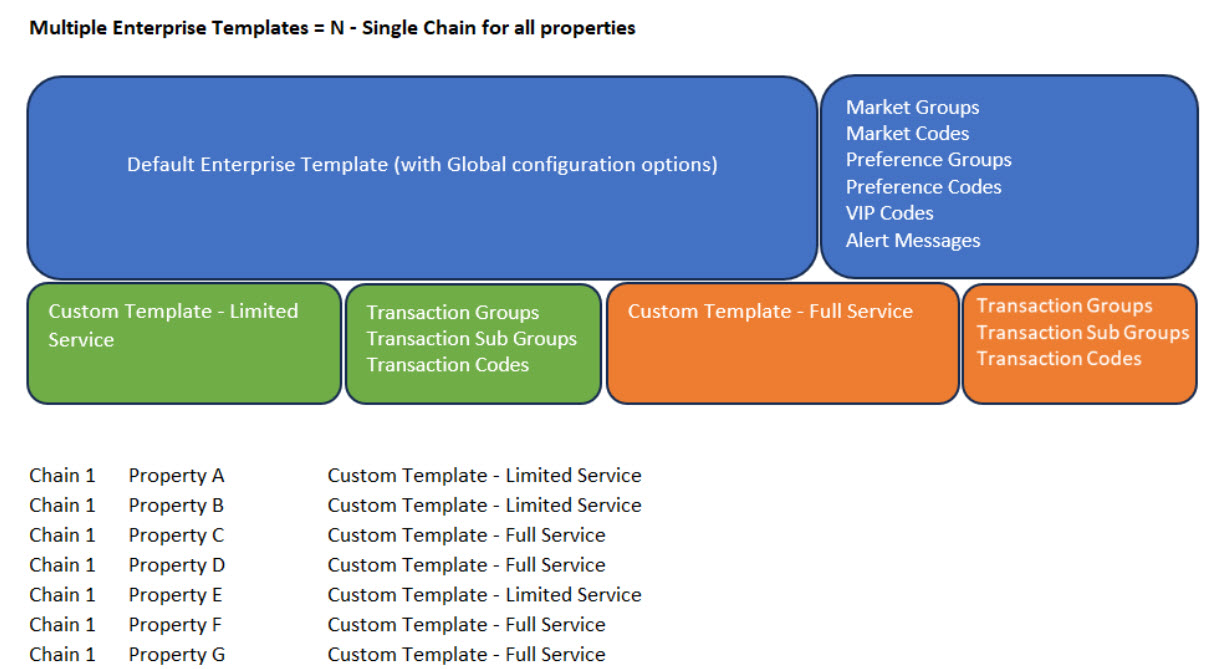

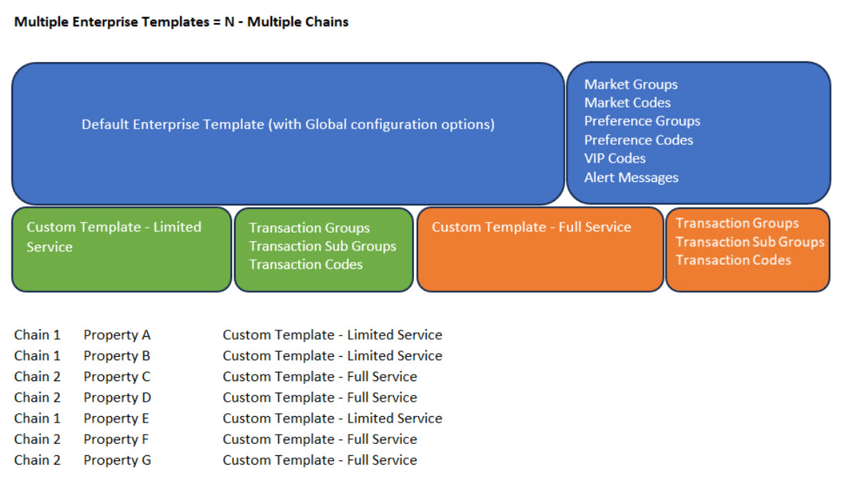

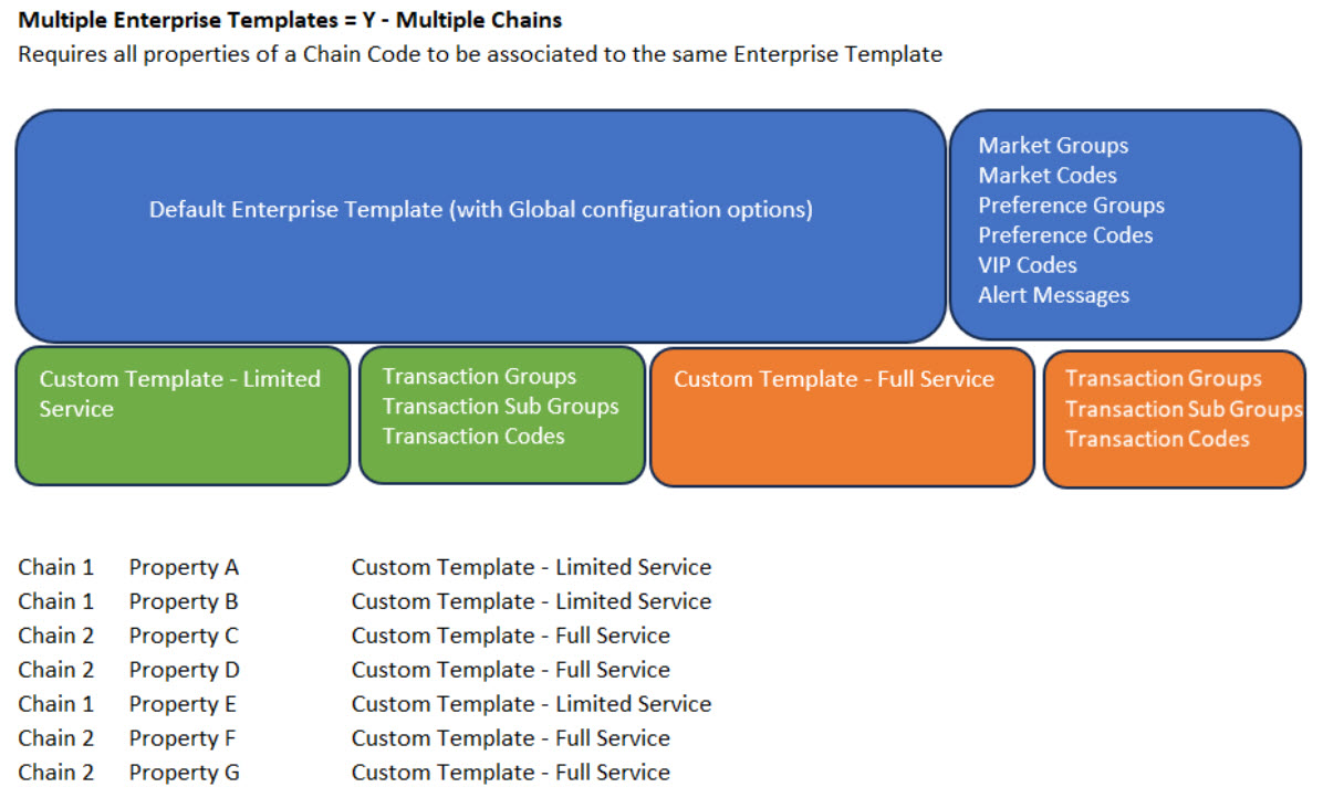

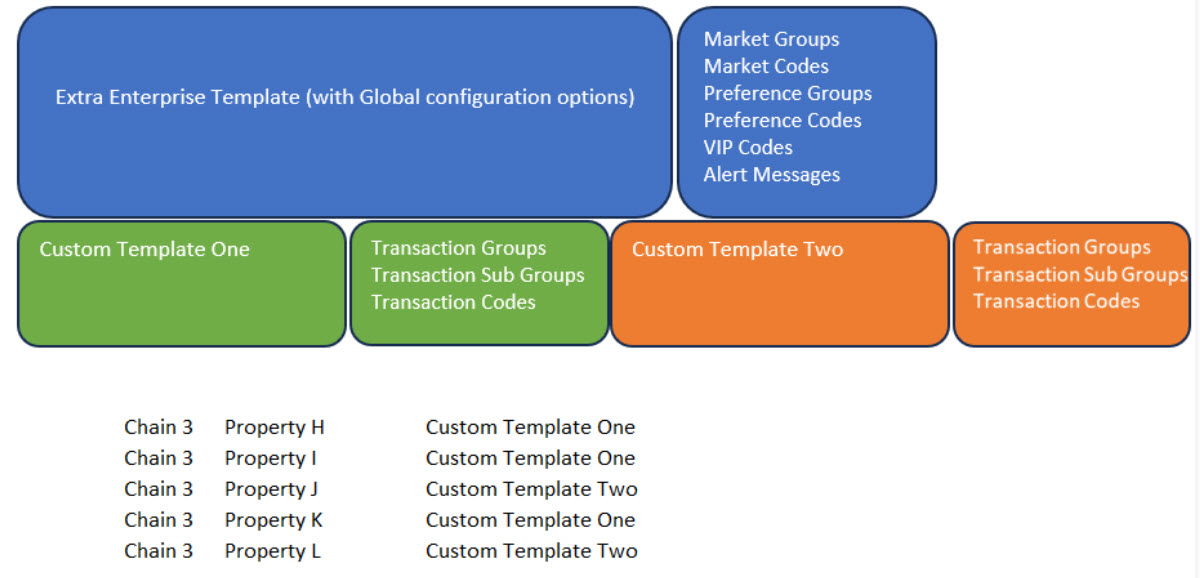

Enterprise Management Templates
Enterprise Management uses templates in a two-level hierarchy to manage configuration across your enterprise.
  • Enterprise Templates - Define standard configurations across all properties in a chain (for example, chain-wide standard configuration).
    • For each template created, a Manage Enterprise Template sub task is auto-created in the Enterprise Template task group; assign this task to user groups for user access to the template.
    • Global (chain-level) configuration, applying to all properties in a chain, is indicated withGlobal icon and can only be configured in an Enterprise Template.
    • Global and property-specific OPERA Controls are available.
      • Global OPERA Controls are indicated with Global icon
      • Complimentary functions are indicated with Tickmark icon in the Complimentary column.
    • Any dependent configuration is fetched from the enterprise template.
  • Custom Templates - Linked to an enterprise template, custom templates define standard configuration for a subset of properties (for example, brand-specific or region-specific configuration).
    • For each template created, a Manage Custom Template sub task is auto-created in the Custom Template task group; assign this task to user groups for user access to the template.
    • Any dependent configuration is fetched from both the enterprise template and custom template.
    • Property-specific OPERA Controls are available.
      • When property-specific OPERA Controls are set up in both enterprise and custom templates, the set up from the custom template takes precedence.
For each template you create, start by selecting the various configuration types, then adding the configuration items (entries) for these options. The configuration types available for selection are dependent on the lowest version at your properties. For example, a configuration type added in 25.x will not be enabled for selection if some properties are currently operating 24.x. Configuration types with dependencies on other configuration types are indicated, for example - Market Codes is dependent on Market Groups. Any seeded entries are populated when the configuration type is selected for a template. See OPERA Cloud Seeded Configuration for details.
Once configuration types are selected in a template, configuration can be entered; either directly in Enterprise Management or imported from a CSV template file. Configuration values have a Pending status initially, and must be approved by a user with the Approve Configuration task assigned. Configuration values can be rejected and configuration values no longer required are updated to Archive status to prevent distribution to new properties. You also have the option to import all supported configuration from an OPERA Cloud property to an unconfigured enterprise template. You can export the configuration entries in a template to CSV files for use externally.
Distributing Configuration
Distribution to the pseudo CSP-Central Sales Property is not supported.
In order to distribute configuration to properties, a custom template is linked to one or more properties; resulting in the configuration from both the enterprise template and the custom template being distributed and upsert (update or insert) in OPERA Cloud. When the Multi Property OPERA Control is active, configuration is upserted (or “updated or inserted”) to both the template (where applicable) and the properties.
When distributing configuration dependent on an OPERA Control (for example, Alerts Messages for the Alerts OPERA Control), distribution fails when the OPERA Control is inactive at the property. Distribution logs will indicate "<property> does not support <configuration type>". OPERA Controls selected and activated in templates are distributed prior to the configuration entries in the templates.
In OPERA Cloud Administration, a Managed By column is displayed in search results, indicating the origin of the configuration.
  • If the configuration is added directly in OPERA Cloud, configuration entries are labeled as "Property Managed".
  • If the configuration was distributed from Enterprise Management, configuration entries are labeled as "Enterprise Managed".
  • If the configuration was distributed from Enterprise Management and overridden by the property, configuration entries are labeled as "Property Overridden" (Requires the Override Enterprise Managed Configuration task). Further updates from Enterprise Manager are declined.
All Enterprise Management configuration changes are tracked in the OPERA Cloud changes log with the user WS_EM_INTERNAL_CLIENT1_APPID.
This image shows the creation of multiple enterprise templates.
