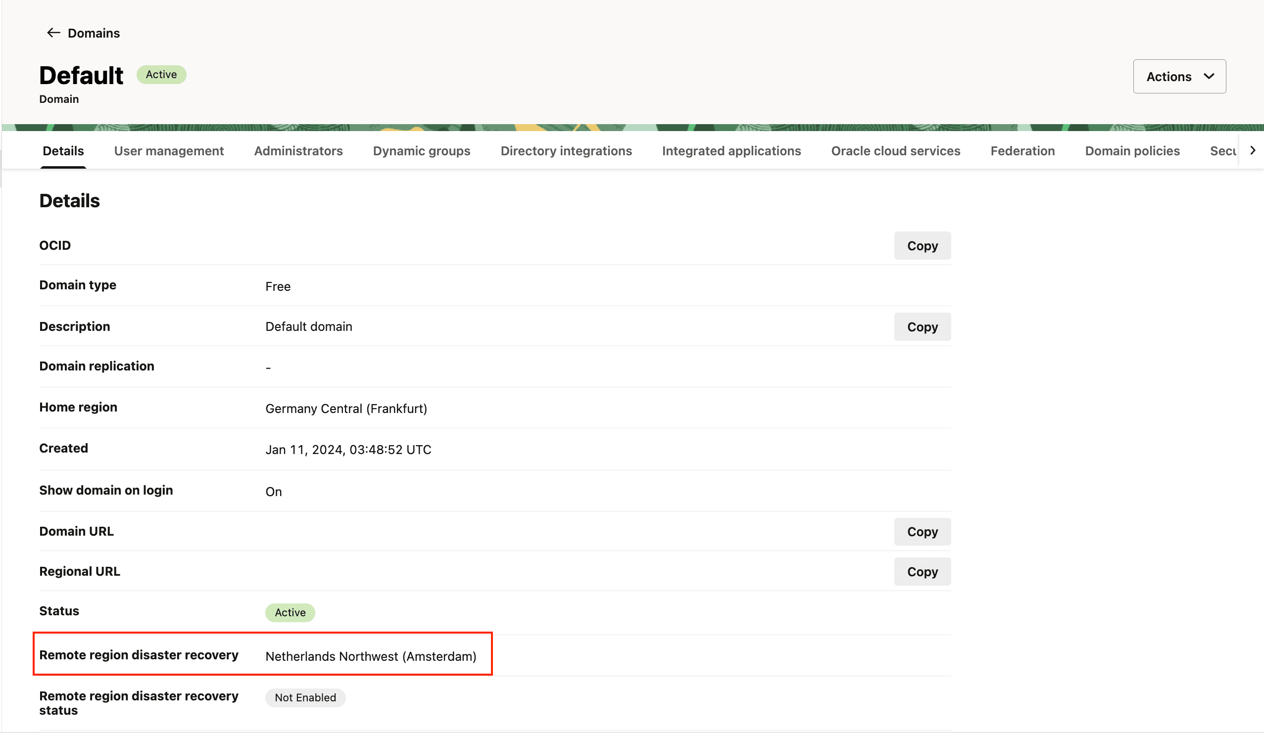

  3. Select the “Default” domain. From the Default domain overview page, note the Remote Region Disaster Recovery region.
    This image shows the default domain and its remote region disaster recovery region.

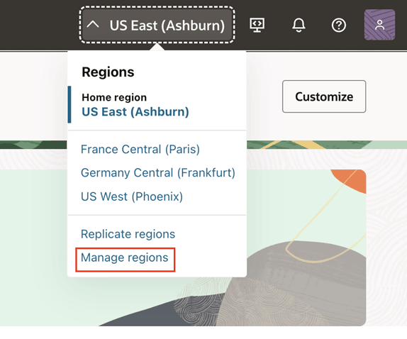

  4. Click your current Region name on the top right corner and then select Manage regions. A table shows the list of Oracle Cloud Infrastructure regions to which you are subscribed or unsubscribed.
    This image shows the Manage regions option from the Region menu.

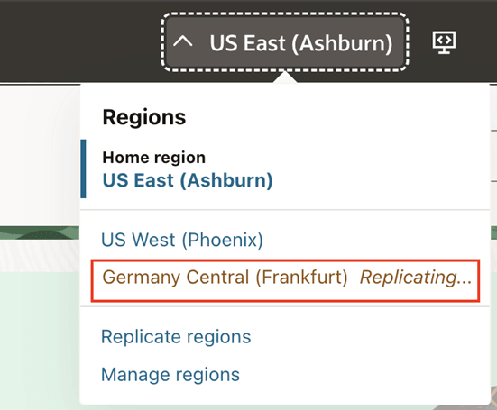

  1. Click your current Region name on the top right corner to see the list of regions subscribed in the OCI tenancy. When you subscribe to a new region, the default identity domain automatically replicates to that region and you will see the "Replicating" status from the Region menu as shown below.
    This image shows the Replicating status on the Region menu.

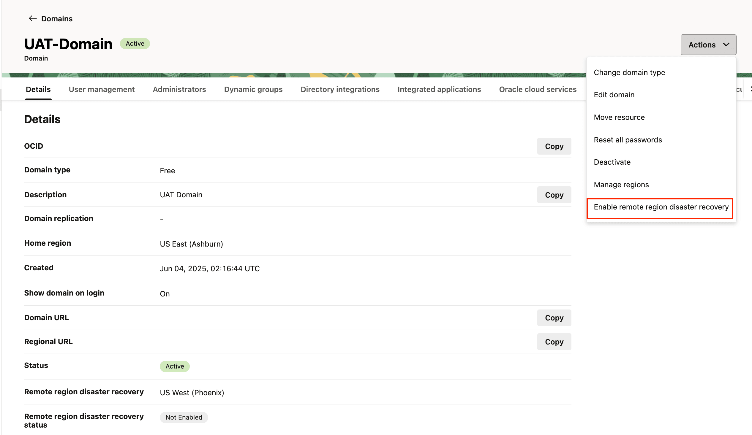

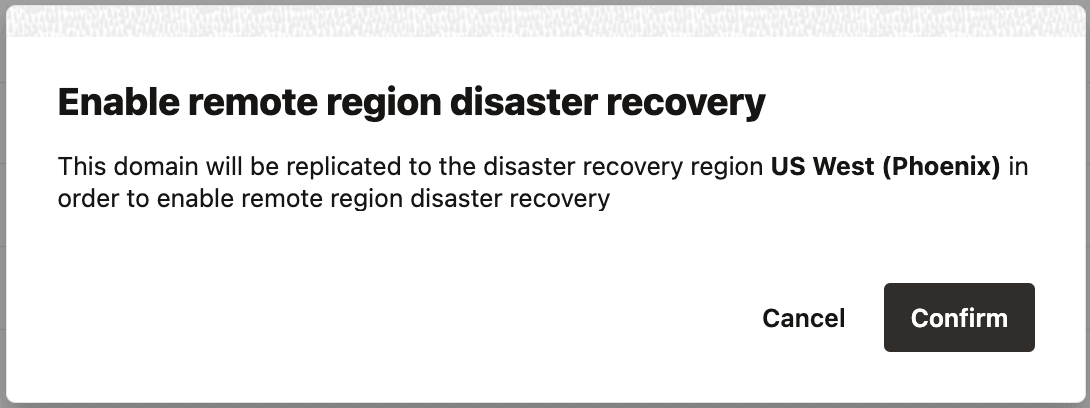

  4. Select Actions and then select Enable remote region disaster recovery.
  5. Select Confirm to enable remote region disaster recovery.
    This image shows the Confirm button to enable remote region disaster recovery.

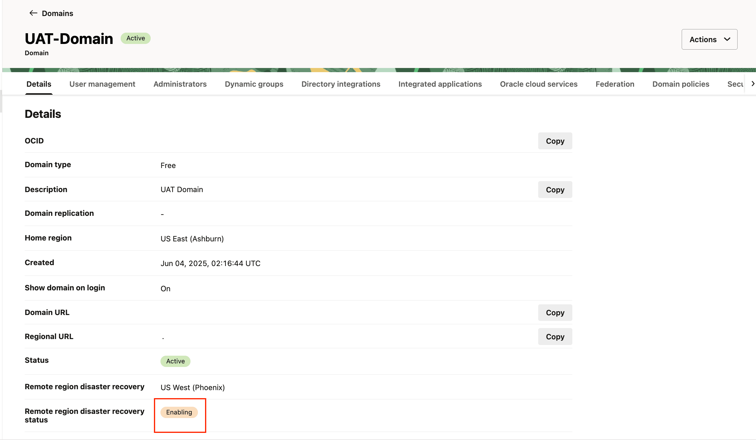

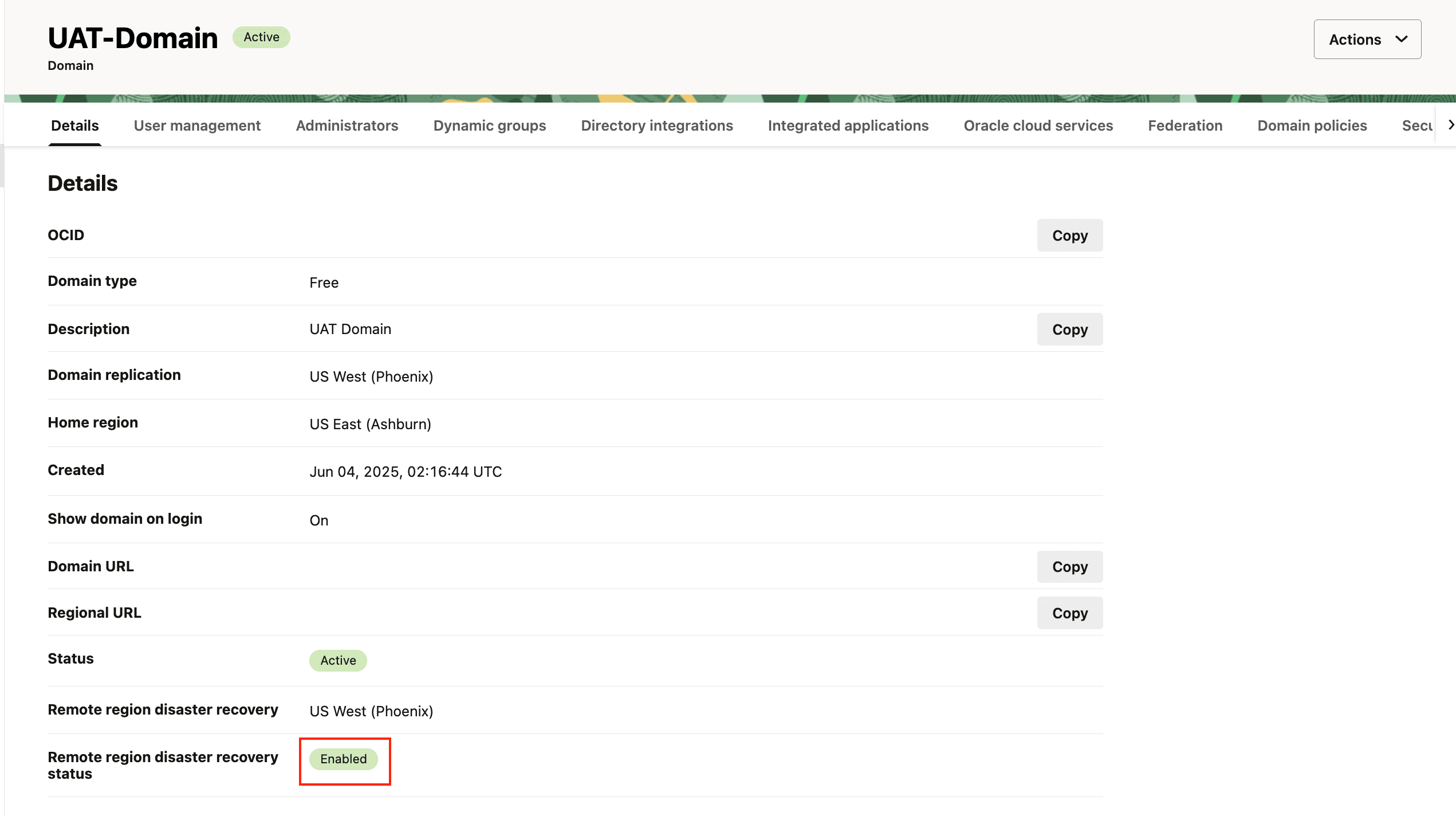

  6. The Remote region disaster recovery status for the Identity Domain will initially appear as "Enabling." Upon the successful completion of the replication process, this status will transition to "Enabled."
    This image shows the UAT-Domain page with "Enabling" status for remote region disaster recovery.
    This image shows the UAT-Domain page with "Enabled" status for remote region disaster recovery.
