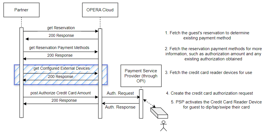

Scenario 2: Guest has New Card for Authorization
Figure 6-2 Sequence Diagram for Scenario 2
This image shows the sequence diagram for Scenario 2 where the guest has a new card for authorization.
Table 6-2 Description of Steps
Description of Steps Operation Samples
1
Partner queries the guest reservation to retrieve the reservation payment method and inform the guest that a credit card pre-authorization can be completed. This can be done at the time the guest is ready for check-in.
The get reservation response includes the payment method on the reservation and the last 4 digits of the credit card. The guest is informed that a credit card settlement is requested on the VISA card’s last 4 digits of 1007.
The guests indicate they are at the hotel and would like to use a different credit card for the reservation.
getReservation
{{HostName}}/rsv/v1/hotels/{{HotelId}}/reservations/{{ReservationId}}?fetchInstructions=Reservation&fetchInstructions=ReservationPaymentMethods
200 Response with reservationPaymentMethods>paymentMethod=VA (VISA) and paymentCard>cardId>id:

2
The Partner can make an additional call to get the reservation payment methods to obtain more information for the reservation payment methods. The response will have the authorizationRule with the amount the site asks for authorizing on the reservation, the approvalAmountNeeded with the amount that is still needed for authorization, and the currentAuthorizedAmount with the amount, if any, of an existing authorization. If approvalAmountNeeded is 0 amount, it is expected that no creditcard authorization is needed.
With the get reservation call and this get reservation payment methods call, the guest can be provided information that a $230 authorization is needed and their VISA credit card with last 4 digits of 1007 will be used for the authorization.
Again, in this scenario, the guests have indicated that they are at the hotel for Check-in and would like to use a different credit card for the reservation authorization. They are at the Kiosk station and prepared to dip/tap/swipe their credit card.

3
The configured credit card reader devices must be known to send with the authorization and settlement requests. A kiosk system might have the credit card reader device attached and it is known. Others will need to fetch the hotels configured external devices to get the id of a configured device to populate the terminalId element in the authorization and settlement APIs. The label is expected to be descriptive to indicate where that reader exists. The deviceArea can also be used to identify an area where more than one reader device can belong.
This configuration does not change often, and it is recommended to cache the result and refresh only if issues occur around the credit card reader devices.

4
With the terminalId and the guest prepared to dip/tap/swipe their credit card, the Partner can initiate an authorization request that will go out to the Payment Service Provider through OPI. The post AuthorizeCreditCardAmount API will trigger the credit card authorization request to be sent out to the PSP for approval. The minimum elements needed in the request body would the cardType and paymentMethod (CP can be used generically), and the terminalId the PSP will activate for the guest to dip/swipe their card (can be retrieved from step 3).
The authorization request will not have any token/card number provided, which indicates to the PSP that a device will need to be activated to capture the credit card from the guest.
The amount to be authorized is populated automatically in the request to PSP as it is retrieved from the authorization rule on the reservation.
You can specify an amount that can be sent in the post AuthorizeCreditCardAmount request body that will be used if needed. This section can be added in the "criteria" for it:
"amount": {
            "amount": "500",
            "currencyCode": "USD"
It is expected that the PSP will activate the device "KIOSKREADER" for an authorization request and prompt the guest to dip/tap/swipe their credit card.
A successful response from the PSP will include the approval code, the new cardId>id, the cardType, paymentMethod, and the amount authorized.
The new card type, expiration date, token, and last 4 digits will be saved to the guest's reservation (overwriting the previous payment method).
If the authorization is declined, the message from the PSP (if provided) for the decline reason will be included.

201 Response:
    "payment": {
        "paymentCard": {
            "cardId": {
                "id": "1002416",
                "type": "CreditCard"
            "cardType": "Mc",
            "cardNumberMasked": "",
            "expirationDate": "2028-07-01"
        "paymentMethod": "MC",
        "authorizationApproval": {
            "approvalAmount": {
                "amount": 230
            "approvalCode": "A1241               ",
            "originalAuthSequence": 1833670
