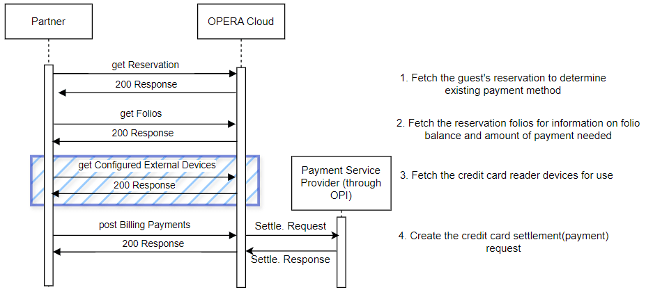

Scenario 3: Settlement on Existing Credit Card Payment Method
Figure 6-3 Sequence Diagram for Scenario 3
This image shows the sequence diagram for Scenario 3 with settlement on existing credit card payment method.
Table 6-3 Description of Steps
Description of Steps Operation Samples
1
Partner queries the guest reservation to retrieve the reservation payment method and inform the guest that a payment can be made on the credit card during the stay (to reduce the charges existing on the reservation folio) or it is time to checkout (to pay for the reservation charges).
The get reservation response includes the payment method on the reservation and the last 4 digits of the credit card. The guest is informed that a credit card settlement is requested on the VISA card’s last 4 digits of 1007.
If the guest verifies this is the card for the settlement, the cardId id value, the cardType, and the paymentMethod found in the get reservation response is used in the request for settlement (postBillingPayments) to indicate use of an existing credit card payment method.
getReservation
{{HostName}}/rsv/v1/hotels/{{HotelId}}/reservations/{{ReservationId}}?fetchInstructions=Reservation&fetchInstructions=ReservationPaymentMethods
200 Response with reservationPaymentMethods>paymentMethod=VA (VISA) and paymentCard>cardId>id:

2
The Partner can use the get Folios call to fetch the amounts that are outstanding on the reservation and inform the guest of their reservation charges and the amount that will be posted to their credit card.
A reservation can have multiple folios open with charges on each. The payment method can also be specific to the folio window. The get Folios response will provide this data.
The roomStay balance amount is the full amount balance on the reservation.
The reservationsFolioWindows section provides the balance amount for the individual folio window number and the payment method set for that folio. Each folio window with a balance amount will need to be settled individually.
getFolios
{{HostName}}/csh/v1/hotels/{{HotelId}}/reservations/{{ReservationId}}/folios?guestPayOnly=true&includeFolioHistory=false&groupType=CheckNo&fetchInstructions=Windowbalances&fetchInstructions=Reservation&fetchInstructions=Payment&fetchInstructions=Payee&simpleFolio=false&limit=100200
Response:

3
The configured credit card reader devices must be known to send with the authorization and settlement requests. A kiosk system might have the credit card reader device attached. Others will need to fetch the hotels configured external devices to get the id of a configured device to populate the terminalId element in the authorization and settlement APIs. The label is expected to be descriptive to indicate where that reader exists. The deviceArea can also be used to identify an area where more than one reader device can belong.
This configuration does not change often, and it is recommended to cache the result and refresh only if issues occur around the credit card reader devices.
getConfiguredExternalDevices
{{HostName}}/int/config/v1/configuredExternalDevices?deviceType=CreditCard&active=true&hotelId={{HotelId}}&deviceCode=ChipAndPin

4
When guests have verified the amount to charge and indicated they would like to use the credit card that is on their reservation, the postBillingPayments call can be made to process the credit card settlement request.
The request body of the post Billing Payments requires the cardId, id, cardType, and paymentMethod retrieved from the get reservation or get folios response.
Also, the terminalId and the postingAmount>amount is needed.
This request will send a settlement request to the PSP through OPI for the credit card that is on the reservation and for the amount asked.
If there was existing authorization up to the amount asked for on the reservation's credit card, a settlement request is processed with that existing approval code.
If there was not an authorization or not enough authorization for the asked for amount, an automatic authorization (or top-up) will be processed first and then the settlement request will be processed.
A successful response from the PSP is returned with the amount, payment type, and transaction information. The payment is saved to the guest's reservation folio and the folio balance will be reduced by that amount.
If the settlement is declined, the message from the PSP (if provided) for the decline reason will be included in the response.

            "postingTime": {
                "time": "2024-07-19 22:32:59.0",
                "timezone": "UTC"
            "revenueDate": "2017-08-27",
            "receiptNo": 8,
            "roundingDifferenceTrx": false,
            "folioWindowNo": 1,
            "deferredTax": false
    "trxCodesInfo": [
            "description": "<CREDITCARD_TYPE>",
            "transactionGroup": "PAY",
            "transactionSubGroup": "CCARD",
            "trxServiceType": "S",
            "transactionCode": "XXXXX",
            "hotelId": "HotelId",
            "printTrxReceipt": false
