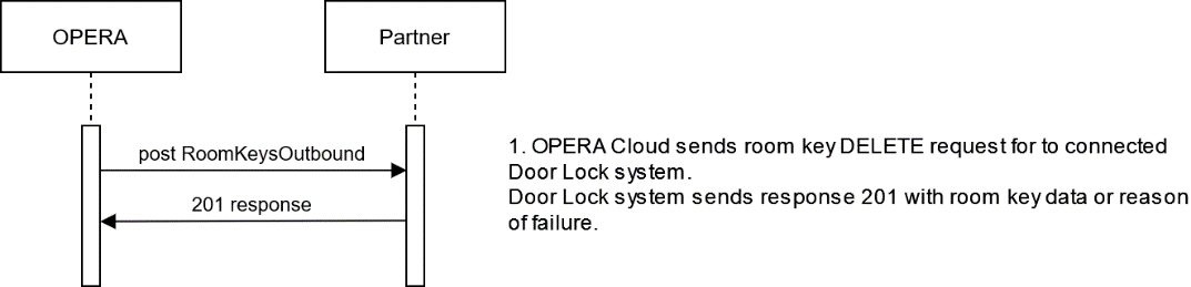

Request for deleting all keys or Pin code for a reservation is sent to the door
lock system from the OPERA Cloud PMS UI.
The door lock system must respond within 20 seconds with a "201" status message
that the room key(s) have been set inactive, or if an unsuccessful request, a "201"
response containing message information on why the request could not be processed.
A PostRoomKeysOutbound request message containing the keyType "Remove" requests
the connected Door Lock system to set all active room keys, Pin code, or mobile key
inactive for a specific reservation/room.
After the Door lock system processed the request, it sends back a 201 http
response message to OPERA Cloud containing the result of the request.
ORACLE Cloud PMS does NOT send another request command automatically should a
negative response be received.
