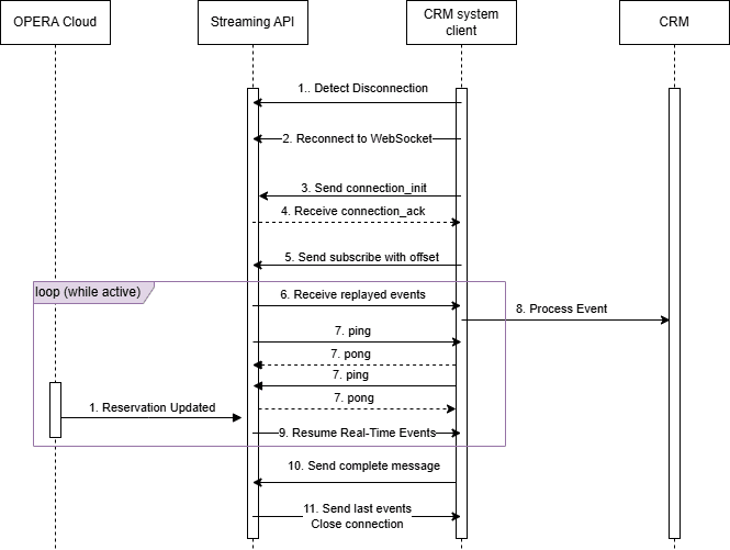

Figure 4-4 Sequence Diagram for Replaying
This image shows the sequence diagram for replaying.
Detailed Steps for Replaying
  1. Detect Disconnection.
    Monitor the WebSocket connection for any interruptions. Upon detecting a disconnection, initiate the reconnection process.
  2. Reconnect to WebSocket.
    A WebSocket is a way to keep a live channel open between your app and the server, so you can receive updates almost instantly.
    Use the hashed key (in Application Key, see "Hashing the Application Key") to build your connection URL. For example: wss://OHIP_Gateway_URL/subscriptions?key=Hashed_Application_Key
    Your client should support the "graphql-transport-ws" subprotocol, so send the header:
    Sec-WebSocket-Protocol: graphql-transport-ws
  3. Send the connection_init message.
    Within 5 seconds of connecting, send the connection_init message to initiate the connection.
    Sample message:
        "type": "connection_init",
        "payload": {
            "Authorization": "Bearer <Access_Token>",
            "x-app-key": "<Application_Key>"
  4. Receive the connection_ack message.
    Upon successful initialization, the server responds with a connection_ack message, indicating readiness to accept subscription requests.
    Sample response:
        "type": "connection_ack"
  5. Send the subscribe message with Offset Parameter
    Send a subscribe message specifying the chainCode and the offset parameter set to the last successfully processed event's offset. This ensures that all events from that offset onward are replayed.
    Use the GraphQL schema to decide which fields to include in the request. Including the primaryKey is advised since this is the internal OPERA ID of the resource to which the event occurred and can optionally be used to GET the resource via the inbound API call.
    Ensure the id is a unique value that will be used throughout the life of this stream, that is, until sending the complete message.
    Sample message:
        "id": "<id>",
        "type": "subscribe",
        "payload": {
            "variables": {
            "input": {
                "chainCode": "<Chain_Code>"
            "extensions": {},
            "operationName": null,
            "query": "subscription { newEvent(input: { chainCode: \"<Chain_Code>\" offset: \"<offset>\"}) { metadata { offset uniqueEventId } moduleName eventName primaryKey detail { oldValue newValue elementName } } }"
    Optionally, you can choose to receive only the changed attributes in the detail array of the events you receive. To achieve this, use the below sample request:
        "id": "<id>",
        "payload": {
            "variables": {
                "input": {
            "extensions": {},
            "query": "subscription { newEvent(input: { chainCode: \"<Chain_Code>\" offset: \"<offset>\" delta: true }) { metadata { offset uniqueEventId } moduleName eventName primaryKey detail { oldValue newValue elementName } } }"
  6. Receive Replayed events.
    The server emits all events from the specified offset onward. Each event is sent as a next message containing the event data.
    See the sample event in Subscribing and Consuming Events.
    Keep a record of the offset value; it is a string, not a number.
    Upon receiving an event, process the data as required by your application. This may involve updating records, triggering workflows, or other business logic.
    Security and Privacy: Treat event payloads as sensitive and mask personal data in logs.
  7. Heartbeats and Keep alive:
    Keep the connection alive and establish the line speed; it is essential to send the ping message every 15 seconds.
    Sample message:
    {"type":"ping"}
    The server will also be sending the client ping messages to which the client must respond with the pong message.
    Sample message:
    {"type":"pong"}
    The server will close the connection if it does not receive a pong within 180 seconds. In Performance Considerations, see "Maintain a Healthy Connection and Token Lifecycle."
    During Backpressure Mode bursts, the server can defer replying to client pings with pong until the burst completes. Treat continued next messages as proof of life.
  8. Process Replayed Event.
    Since the volume of events can be large, writing to a cache before updating a database is advised.
  9. Resume Real-Time Event processing.
    After processing all replayed events, the system will continue to receive and process new events in real-time, ensuring ongoing data synchronization.
  10. Send complete message.
    When you intend to stop receiving events, send a complete message to terminate the subscription. Ensure you use the same ID as in the subscribe message.
    Sample message:
      "id": "<id>",
        "type": "complete"
  11. After sending the complete message, wait until the last events are received, then wait until OHIP closes the WebSocket connection. Do not close the connection from the client side.
    Ensure there is a minimum of 10000 ms (10 seconds) between sending the "Complete" message to close a WebSocket connection and sending the next "Subscribe" message to reopen a WebSocket connection.
