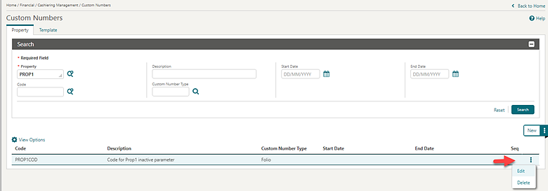

Editing Custom Numbers
The Edit Formula dialog enables you to change the elements on a formula.
                        From the Administration menu, select Financial, select Cashiering Management, and then select Custom Numbers.
                        Select or confirm the Property, enter additional search criteria, and click Search.Note: You can show or hide inactive custom numbers from your search by clicking the page level vertical ellipsis.
                        From search results, click vertical ellipsis, and select Edit.
                        Update the available fields
                        Inactive. Select check box to mark this custom number inactive.
                        Click the pencil icons to update the Custom Number Formula or the Filter Condition.
- Click Save.
Deleting Custom Numbers
                        From search results, select the Custom Number, click the vertical ellipsis, and select Delete.
- Click Delete to confirm.
