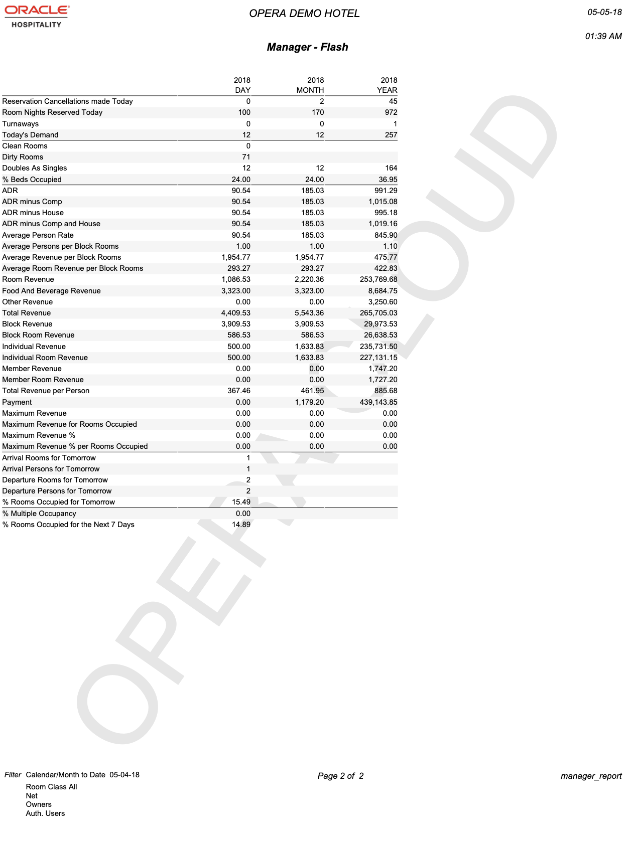

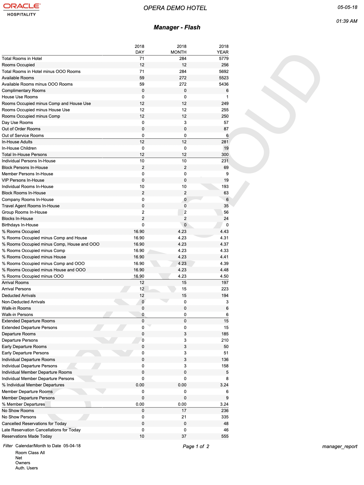

Generating the Definable Manager’s Report
You can test the changes made to the Manager’s Report layout by generating a preview of the list of predefined statistics.
From the OPERA Cloud menu, select Reports, select Configure Reports, and then Definable Manager's Report.
On the Definable Manager's Report screen, click the vertical ellipsis and then click Report.
In the Report Destination pop-up, select Preview, Email to Print, Email or Fax option and click Process.
