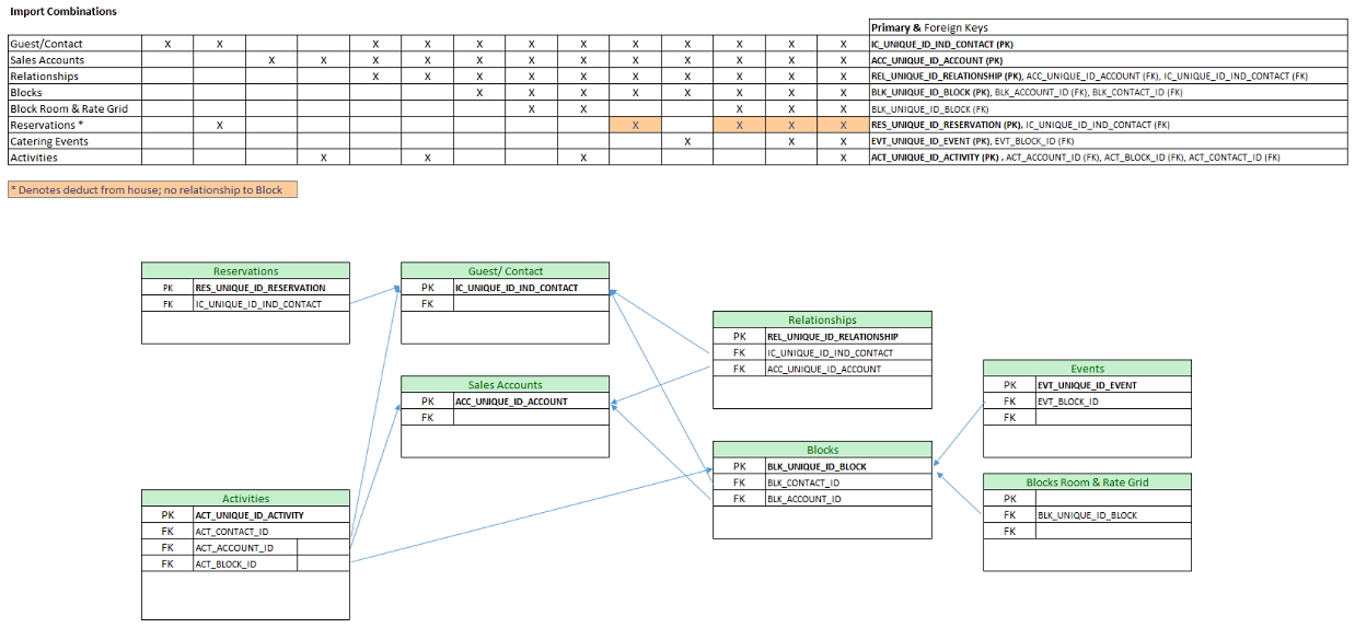

Data Type / Entity Relationships
To establish the relationship between records in each data type, the Unique ID primary key (PK) values are referenced as the foreign key (FK) IDs in other entities.

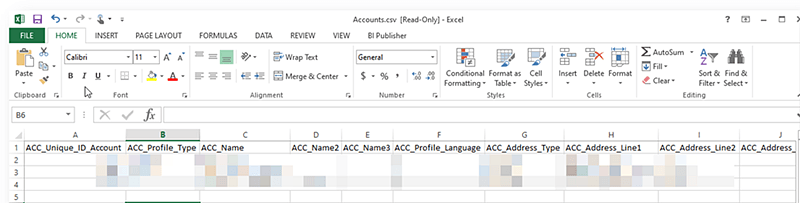

Preparing Template Data Files
From the side menu select Toolbox, select System Setup then Import Data.
Click Download Templates to download a templates.zip file to your workstation.
Open the ZIP file and extract the CSV files to a folder.
Navigate to the folder, open and prepare the CSV file data based on the templates requirements.

Sales Account Profiles (Company/Agent/Source)
The ActiveYN field for Sales Accounts defaults to Y for all imported profiles.
Table 25-12 Sales Account Profiles (Company/Agent/Source)
| Column Name | Description | Max Data Length | Sample Data | Mandatory |
ACC_Unique_ID_Account (PK) |
Unique ID value for Sales Account in the uploaded csv files for data type Accounts within an import cycle. |
Ex: (40001, AC40001) |
ACC_Profile_Type |
The type of sales account. The account type can be TA, Source, and Company. |
Ex: ( TA, Source, Company) |
ACC_Name |

Records reference the ACC_Unique_ID_Account and IC_Unique_ID_Ind_Contact values from Sales Account and Guest/Contact data files respectively.
The default relationship between the account and Guest/Contact profile will be Employer (Type: ACCOUNT) and Employee (Type: CONTACT) relationship.
Table 25-13 Relationships (Account/Contact)
REL_Unique_ID_Relationship (PK) |
Unique ID value for Relationship in the uploaded csv files for Data type Relationships within an Import cycle. |
200 |
Ex: (50001, RL50001) |
ACC_Unique_ID_Account (FK) |
Foreign Key: Linked Unique ID value of Sales Account Profile. Reference PK value from Sales Account data file within an import cycle. |
200 |
Ex: (40004, AC40004) |
IC_Unique_ID_Ind_Contact (FK) |
Foreign Key: Linked Unique ID value of Guest/Contact Profile. Reference the PK value from Guest/Contact data file within an import cycle. |
200 |
Ex: (30003, INC20003) |
Parent topic: About Data Import
Importing Reservations
Records reference the IC_Unique_ID_Ind_Contact from the Guest/Contact data file.
Reservation Status is auto-populated with values: Reserved (if arrival date is greater than business date), Arrival (if arrival date is equal to business date).
Valid credit card payment methods can be specified (credit card numbers are not supported), check payment method and cash payment method. Direct Bill payment type is not supported. When the Mandatory Method of Payment OPERA Control is active, validation will occur and an error presented if the Payment Method is not defined for a reservation.
All reservations are imported irrespective of the room type or house availability or rate restrictions.
Table 25-14 Reservations
RES_Unique_ID_Reservation (PK) |
Unique ID value for reservation in the uploaded csv files for Data type Reservations within an Import cycle. |
200 |
Ex: (30001, INC20001) |
Foreign Key: Unique ID for Linked Guest Profile. Reference PK value from Guest / Contact Profiles data file for an Import cycle. |
