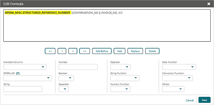

To create or edit SQL expressions, use the Edit Formula box or the Edit Condition box available in the Generation Details section of the Custom Numbers screen. These panels provide selectable values to build an SQL expression using String, Number, Date, Boolean, and conversion functions. You can also select from a list of SQL functions, separators, operators, and table columns (fields) such as ADDRESS1, ADDRESS2, ARRIVAL, BILLING_CONTACT_NAME, BIRTH_COUNTRY, and so on. These columns are a combination of data from Property details, Profile, Reservation, and Folio tax tables; they are specific to the reservation for which the custom number is being generated.Note:
To join multiple string elements together use the ‘||’ concatenation operator in your expression.Examples of Basic and Advanced Custom Number Formulas:
RESORT || '-' || DEPARTURE || '-' || CONFIRMATION_NO.Basic expression which generates a custom number that combines the property code, the departure date, and confirmation of a reservation; the resulting custom number could look like this: PROP1-04052020-780005823 -
OPERA_MISC.REFERENCE_NUMBER_WITH_WEIGHTS(INVOICE_NO,731,'BACK’)Advance expression which generates a custom number using the Reference Number with Weights function, based on the invoice number field, using 7-3-1 weights calculated from the back.

Custom Number Formula: Click the pencil icon to create or edit an SQL expression for generating a custom number. For more information, see Using the Expression Editor.
Filter Condition: Click the pencil icon to define or edit an SQL expression to specify the conditions under which the custom number is to be generated. For more information, see Using the Expression Editor.
