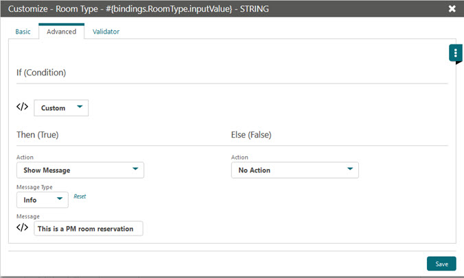

Example 1-6 Example 6
Stay Details — If the room type code = PM and the Print Rate = Y, then show a message to the user.
#{bindings.RoomType.inputValue == 'PM' ? true : #bindings.PrintRate.inputValue == 'Y' ? true : false}
Figure 1-16 Customize screen — Advanced tab
This figure shows the Advanced tab on the Customize screen and an If condition that results in a message appearing to the user.
