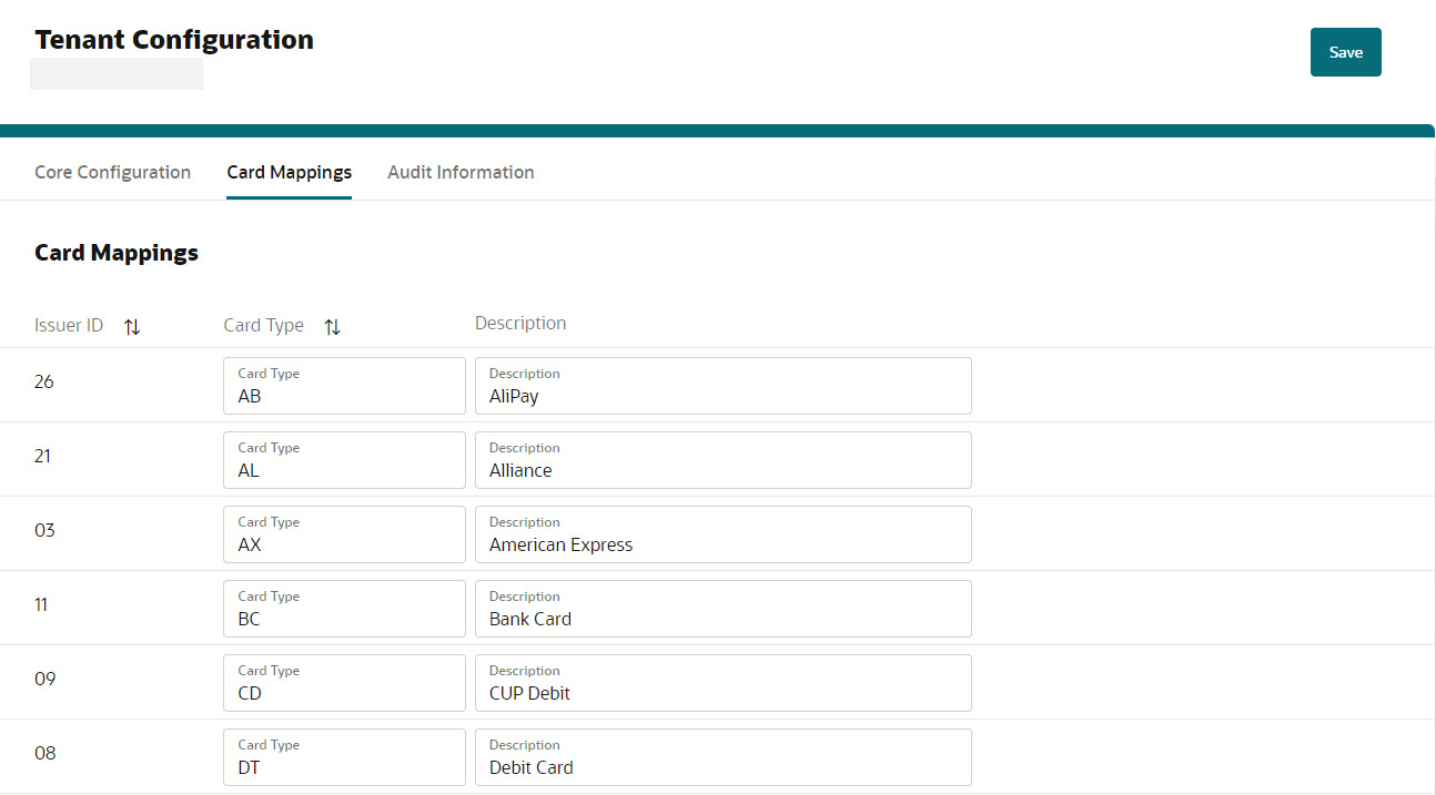

View/Update Card Mappings
To view/update card mappings:
The OPI Cloud Tenant Configuration portal landing page appears once you configure the property through OPERA Cloud.
Select the Card Mappings tab.
The Card Mappings screen appears.
If required, make necessary changes to the Card Mappings:
Card Type: View or update the card type, if required. The card type here should match with the Payment Type configured in OPERA Cloud.
Description: View or update the card description, if required.
Issuer ID cannot be edited. -
Click Save.
You will see a confirmation that Card Mappings has been updated successfully.
You will see a message ‘Configuration update may take up to 15 mins to reflect in runtime’.
