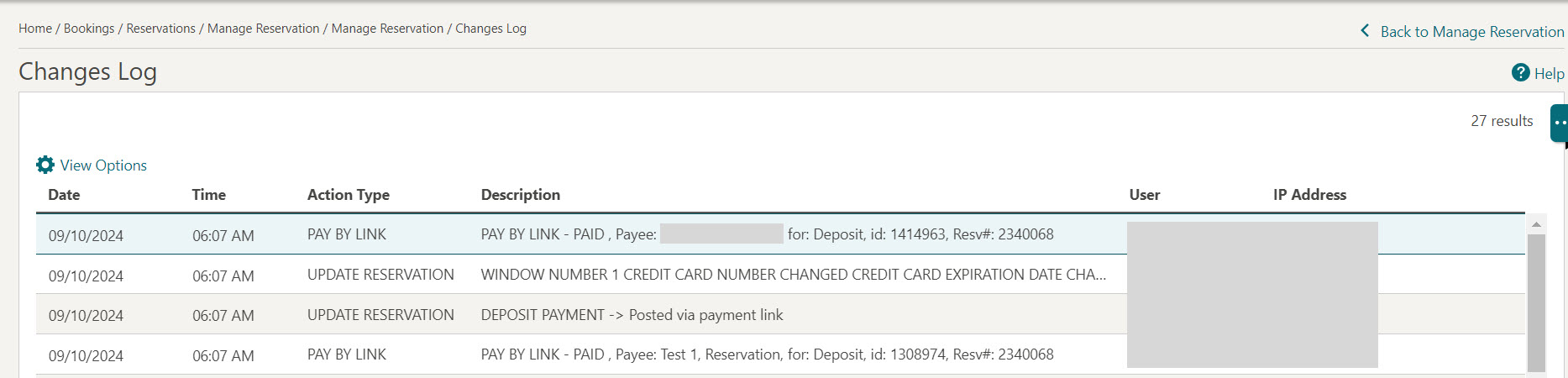

View Changes Log
  • Click I Want To… and select Changes Log.
  • Cancel Reservation changes log records the payment status check details.
    This image shows changes log records for cancel reservation
