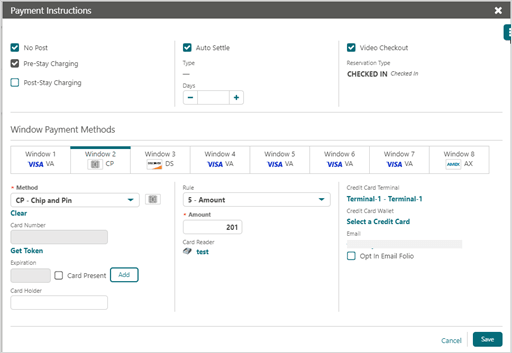

Click I Want To…and select Payment Instructions.
Click Window 2.
Select Payment Type as CP-Chip and Pin and the Authorization Rule as needed.
Click OK to save.

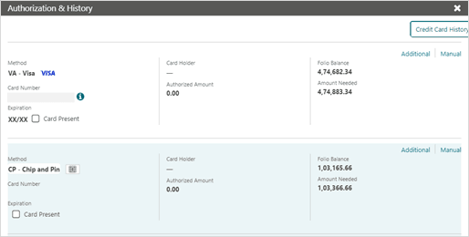

Click the vertical ellipsis and select Credit Card Authorization.
Select the alternate payment (in this case CP) from the Window 2 and select Additional option.

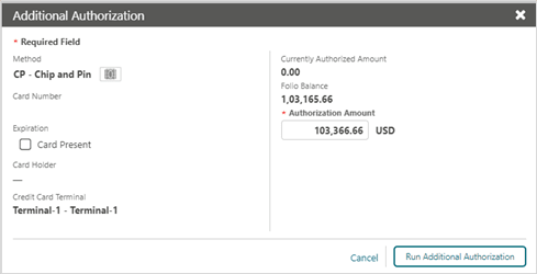

Verify the Additional Authorization Amount to be authorized and click Run Additional Authorization to activate the Payment Terminal for Chip & Pin.
Follow the prompts on the Payment Terminal Device to complete the transaction.
