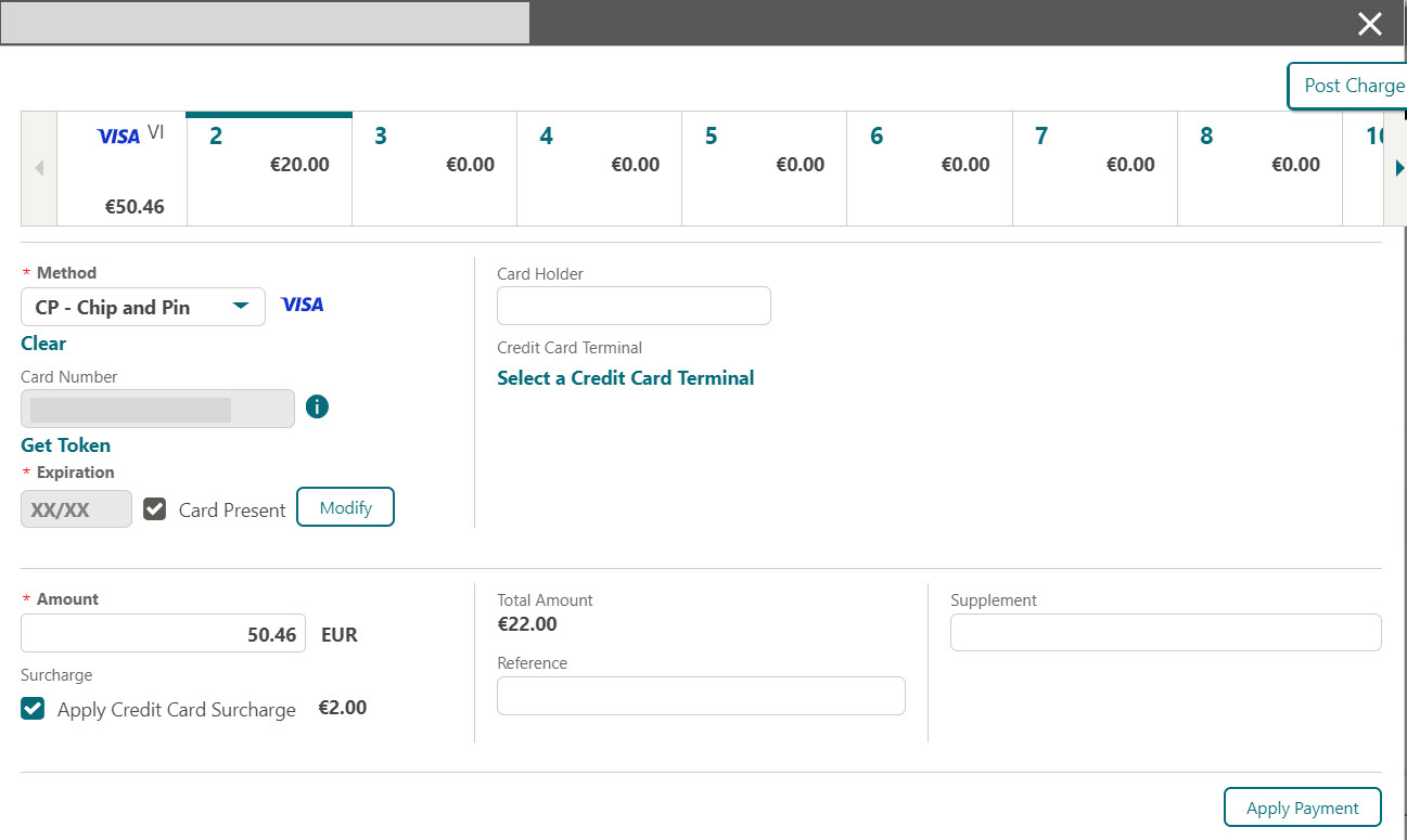

  7. Apply Surcharge: Select to apply a credit card surcharge (available when the Credit Card Transaction Surcharge OPERA Control is active).
    If you are using the Automated Credit Card Surcharge feature in OPERA, the CP Payment type does not add the surcharge. If you need a surcharge to be added, refer to the above steps for details
  8. Enter the payment Amount to be charged and click Apply Payment. This activates the payment device.
    This image shows how to apply a credit card surcharge
