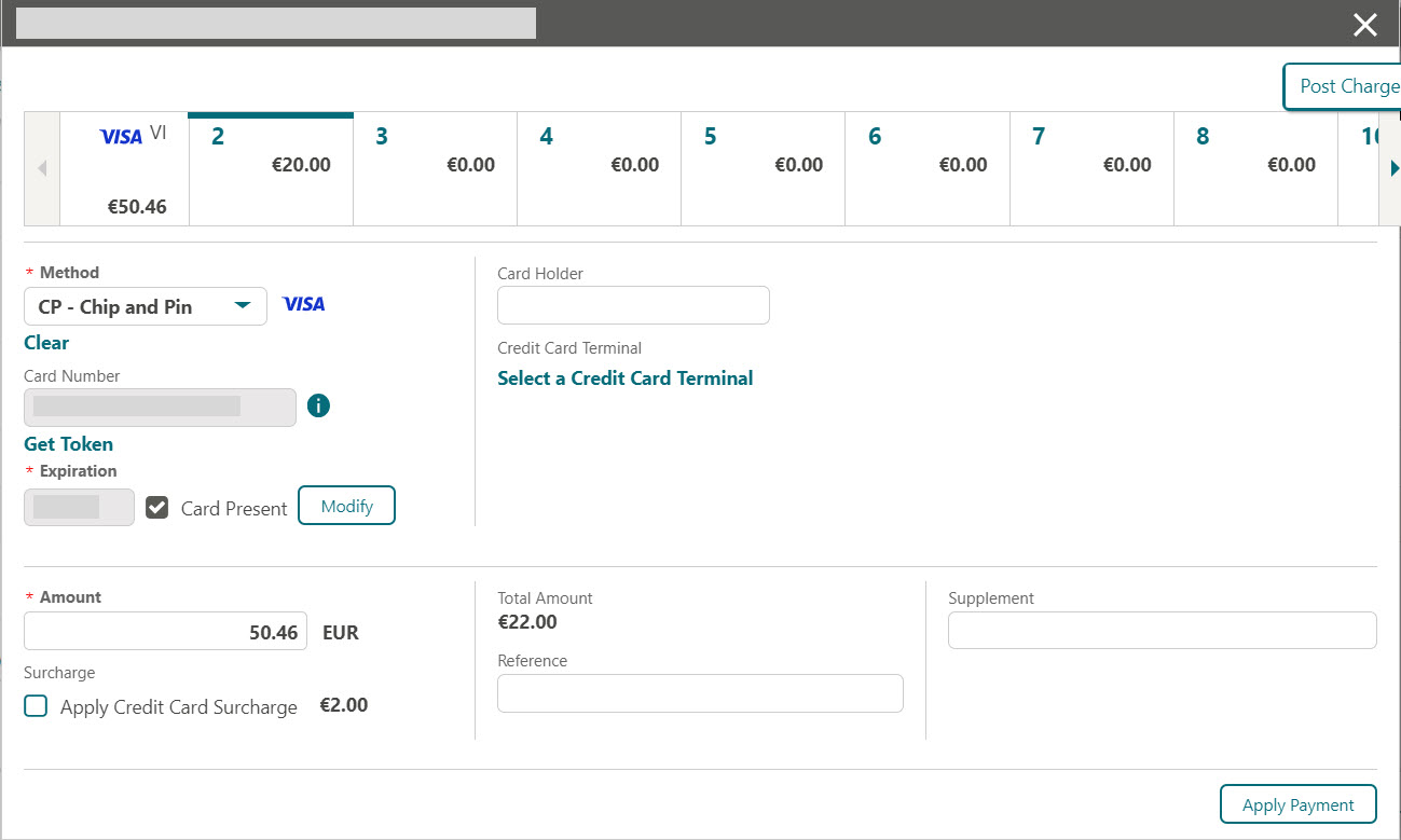

  6. Click the Payment Method drop-down and select the payment type as CP-Chip and Pinor Pay Only.
  7. Enter the payment Amount to be charged and click Apply Payment.
    This image shows payment using a card presented by the guest
