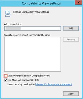

To access Token Proxy Service web portal using Internet Explorer (IE), you need to edit the IE settings as given below:-
Add URL to IE Trusted Sites list.
Deselect “Display intranet sites in Compatibility view” check box in IE compatibility view settings.
