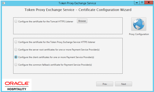

For PSP Client certificates, after login select the option Configure the client certificates for one or more Payment Service Provider(s).

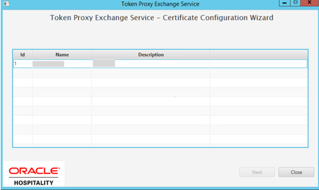

You will be provided with a list of the Payment Service Providers that are configured in your TokenProxy Webportal.
Select the Payment Service Provider that you want to assign a certificate to. If you need to add certificates to multiple Payment Service Providers, repeat the process for each as required.

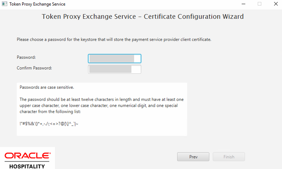

Click Next to choose a password for the keystore.
Provide and confirm the password that meets the minimum requirements, for the keystore that will store payment service provider client certificate.

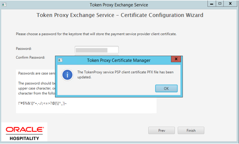

Click Finish to configure payment service provider client certificate.
The TokenProxy service PSP client certificate PFX file has been updated with OPI_PSP_1.pfx in directory: \TokenProxy\TokenProxyService\key.
If all PSPs require an update have been updated, click OK to return to the option selection screen.
