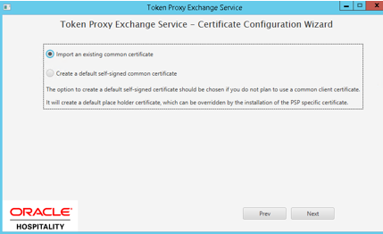

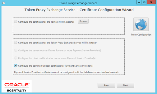

For the PSP Common certificates, after login select the option Configure the common fallback certificate Payment Service Provider(s).
You will have two options. If you select the first option Import an existing common certificate, then the Cert Manager allows you to import an existing certificate by browsing or using drag and drop. Click Next.

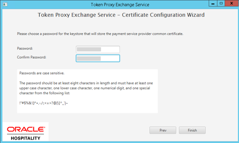

Click Next to proceed to choose a password.

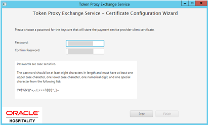

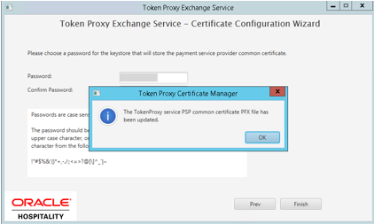

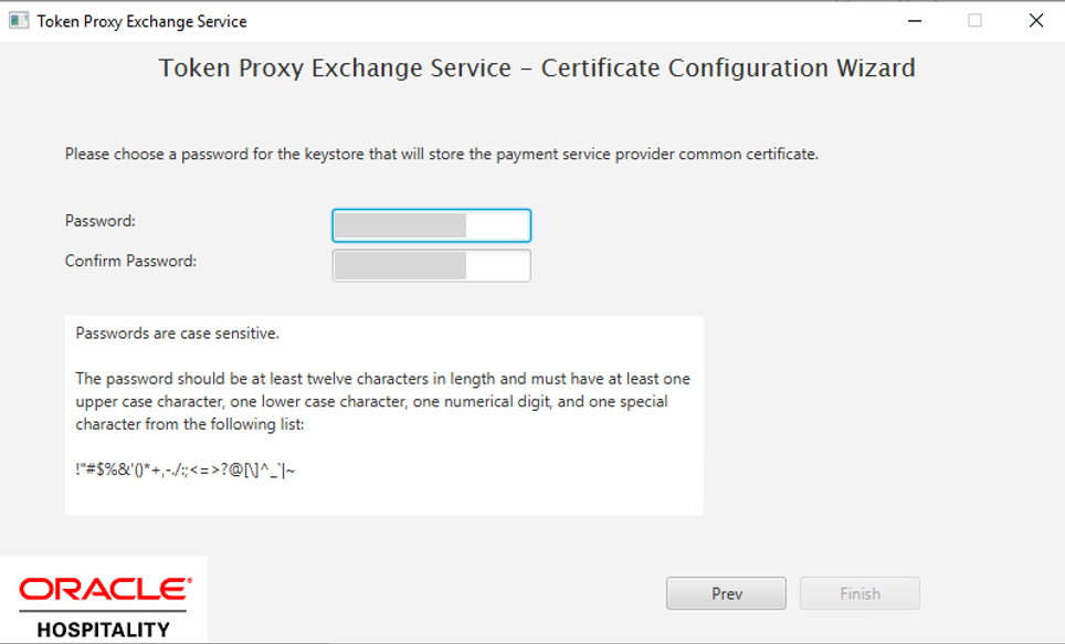

Provide and confirm the password that meets the minimum requirements, for the payment service provider common certificate that will be created.
Click Finish to create the payment service provider common certificate.
The TokenProxy service PSP common certificate PFX file has been updated with OPI_PSP_1Root in directory: \TokenProxy\TokenProxyService\key.
Click OK to return to the option selection screen.

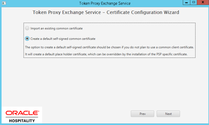

Select the second option Create a default self-signed common certificate.
Click Next to choose a password for the keystore.

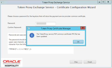

Provide and confirm the password that meets the minimum requirements, for the root certificate that will be created.
Click Finish to create a default self-signed common certificate2.
