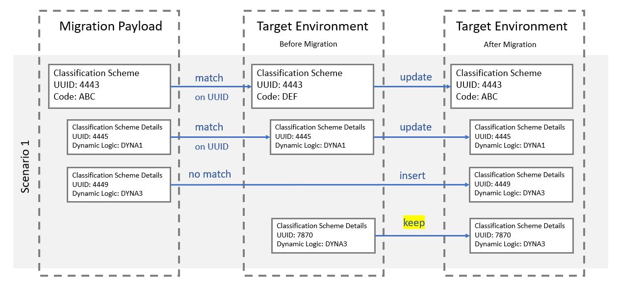

Because details are matched on UUID alone, updates to details that have not been created by a prior migration follow a replacement pattern (that is as opposed to an 'update' pattern). This is illustrated in scenario 1; the rule step referring to RULE 3 has been keyed in on both the source and target environment.
If an item (top level or detail) is matched on functional key then the existing item adopts the UUID in the migration payload.
