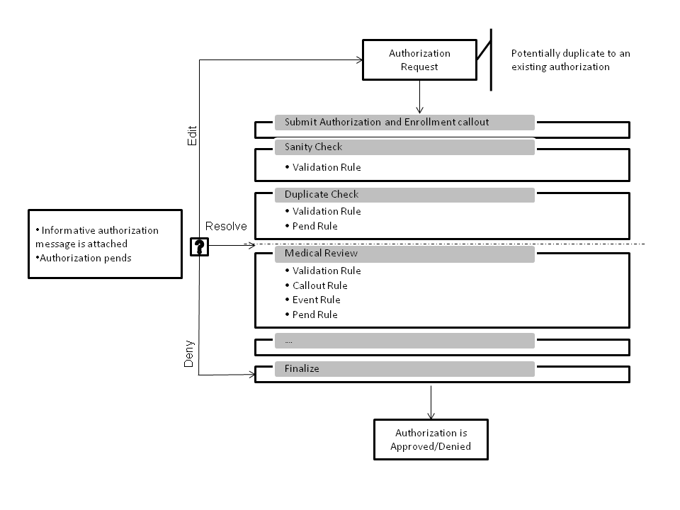

Duplication Check
The authorization processing might be required to be suspended for manual intervention. Pend rules help to achieve this. An authorization is pended with a pend reason when a pend rule evaluates to true. This example shows how a pend rule can be configured so that processing can be suspended when certain conditions are met.
The process step is configured as:
| Process Step | Rule Step | |
Duplication Check |
Validation Rule |
Duplication Check |
Pend Rule |
Potential Duplicate |
The validation rule is configured as:

The dynamic logic DYLO_VAL_DUPECHECK uses predefined search methods to find potentially duplicate authorizations. If this validation evaluates to true then the message MSG_VAL_DUPECHECK will be added to the authorization.
Now, it is desired that when MSG_VAL_DUPECHECK is attached, then the authorization must pend. To achieve this, a pend rule is configured as:

Here the pend rule has only one fixed criterion i.e. the message on the authorization should be 'MSG_VAL_DUPECHECK' for the pend rule to apply.
- Note
The presence of a fatal message on the authorization will not trigger the rule as the indicator Suppress When Fatal is set to 'Y'.
The system also needs to notify the workflow system if such a pend occurs; for this, the pend reason must have the indicator publish set to 'Y'. The pend reason is configured as:
