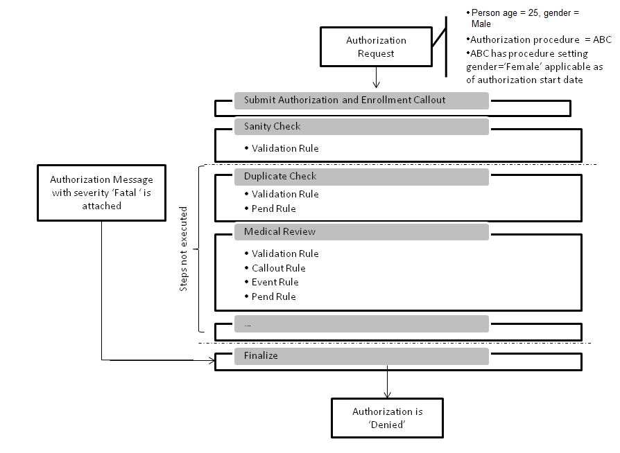

Suppose that the authorization is requested for a male person aged 25 for a procedure ABC and procedure ABC is configured so that no age restrictions apply but is allowed only for the gender 'Female'. In this situation, the validation will evaluate to true and the message MSG_VAL_SANITYCHECK_FAILED will be attached to the authorization.
The message MSG_VAL_SANITYCHECK_FAILED is setup with a severity 'Fatal'. Therefore the system does not execute any subsequent process steps and moves to the finalize step where the authorization is denied.
If the authorization was requested for a female person for procedure ABC or if the procedure requested was something else, the sanity checks would pass and the system would move on to the next configured process step.
The image below summarizes the processing details:
