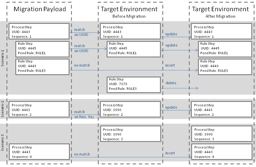

The migration function creates, updates and deletes configuration. To do this, the function needs to recognize the same configuration item across environments. Finding the existing counterpart of a configuration item in the migration payload is called matching.
Matching top level items is a two-pass process. The first pass attempts to match the universally unique identifier (UUID) of the item in the migration set to an existing item on the target environment. The UUID is a system generated key, that is assigned to each configuration item upon creation, unless created through a migration. If the item is created through a migration the UUID of the item in the migration payload is adopted. This ensures that the UUID for the same configuration item is the same across all environments, as long as the migration function is the only means of creating new configuration items on target environments. If the function succeeds in finding an existing configuration item with the same UUID, then that item is updated.
If the UUID match fails, the second pass attempts to match on a functional key, that is a user defined key. For most configuration items the "Code" field is the functional key. This means that if the item in the migration payload has the same code as an item in the target environment then it is considered a match. Some configuration items have a more elaborate functional key, because they do not have a code, for example, a provider pricing clause. For these items the secondary match is based on a combination of functional attributes.
Top Level Authorization
The reason for the two-pass approach is that neither UUID matching, nor functional key matching is foolproof; matching exclusively on UUID fails if the same configuration already exists on the target environment (inserted by means other than migration), matching exclusively on the functional key fails when (part of) the key is updated on either environment. The two-pass approach counters these drawbacks - it gives robustness against updates of key fields and the ability to identify the same configuration items across environments.
Some functional keys comprise language dependent fields. The functional keys in the migration set are the keys in context of the default language on the source environment. Upon import, language dependent functional keys are interpreted in context of the default language of the target environment.
If neither the UUID nor the functional key matches, the migration import function inserts the configuration item on the target environment. If matched successfully, then all functional attributes of the existing item are updated with the value provided in the migration payload. Any existing detail matched with a detail in the migration set is updated. Details in the migration payload that do not exist on the target environment are inserted.
If the migration set does not specify an inclusion date, then any existing detail that is not matched, is deleted.
Because details are matched on UUID alone, updates to details that have not been created by a prior migration follow a replacement pattern (that is as opposed to an 'update' pattern). This is illustrated in scenario 1; the rule step referring to RULE 3 has been keyed in on both the source and target environment.
If an item (top level or detail) is matched on functional key then the existing item adopts the UUID in the migration payload.
