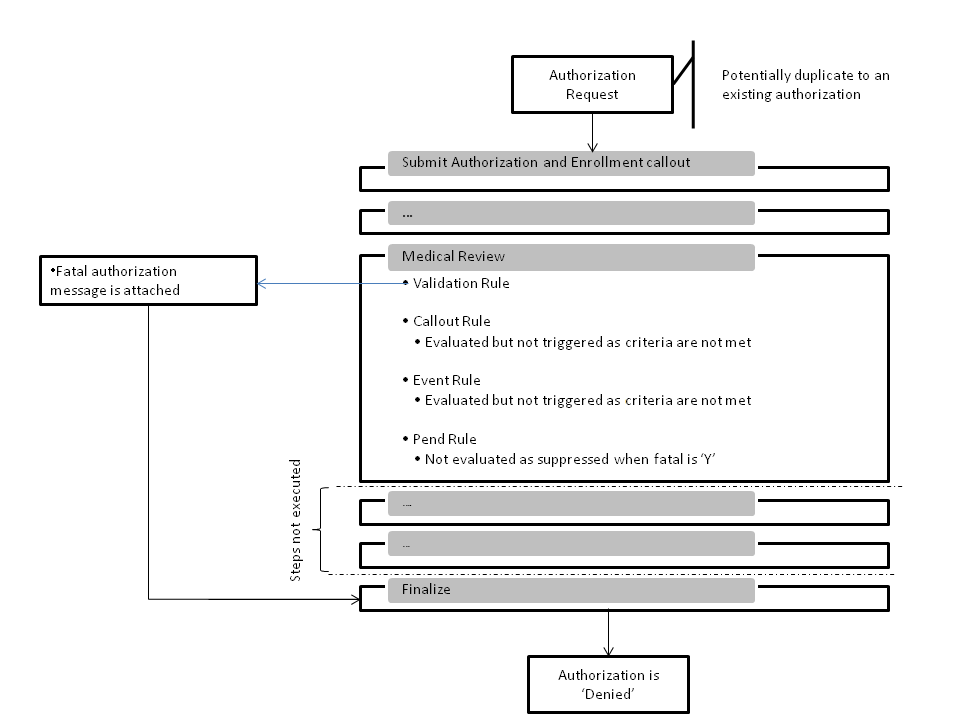

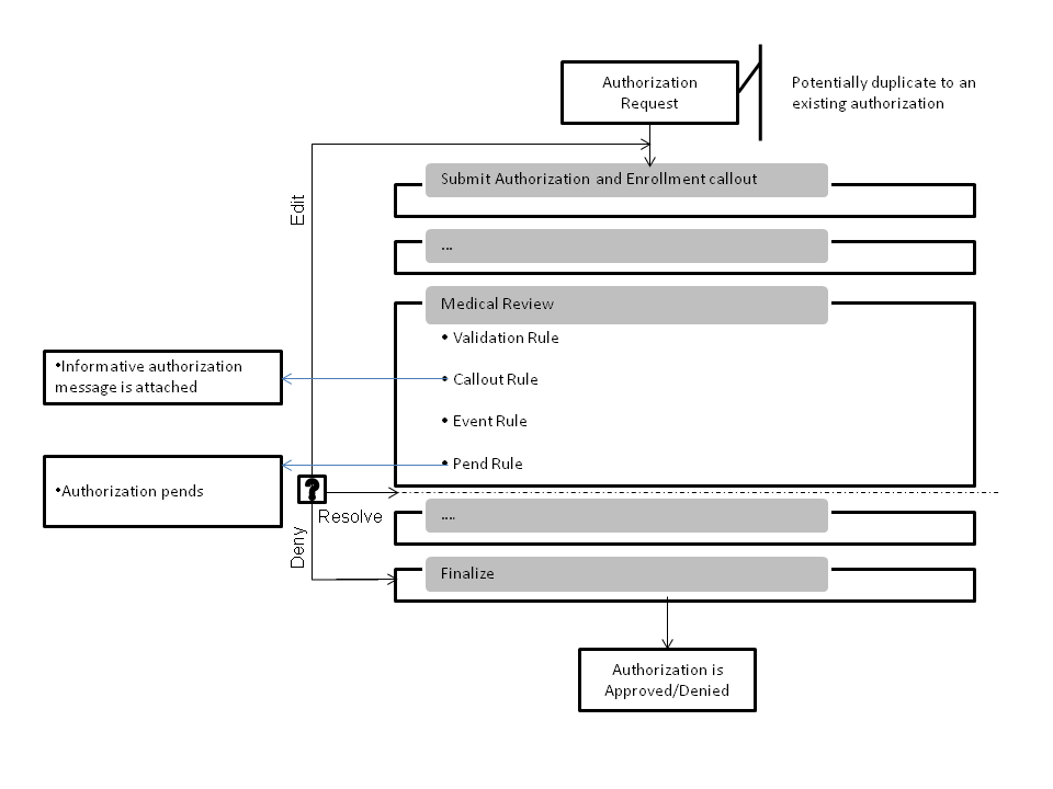

The images below show the following situations:
  1. When the Combination Check fails and a fatal message is attached
  2. When the Combination Check passes, but the documents are missing
Image #1:
Scenario Mediacle Review 1
Image #2
Scenario Mediacle Review 2
