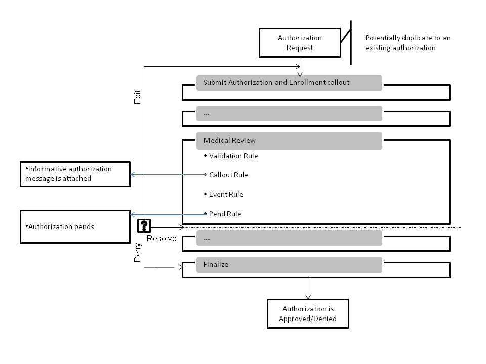

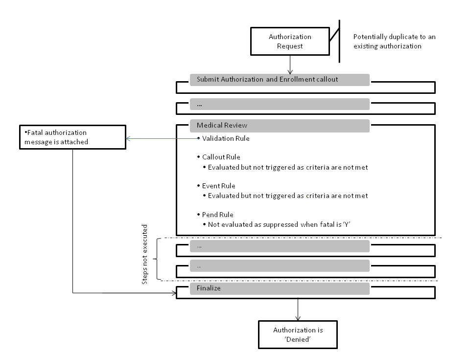

The images below show the following situations:
  1. When the Combination Check fails and a fatal message is attached
  2. When the Combination Check passes, but the documents are missing
Image #1:
Scenario Mediacle Review 1
Image #2
Scenario Mediacle Review 2
What If?
If missing diagnostic information should not lead to automatic denial of the authorization but should force the authorization for manual intervention then:
  1. The pend rule can be configured to check for both the messages: if either of them is present the authorization will pend. This can be done by adding the validation message to DOC_MISSING_GRP and the pend rule should now have message group DOC_MISSING_GRP as fixed criterion. Two pend rules can be configured. This option can further provide more flexibility in terms of reattaching a pend reason. It might not be of interest to pend the authorization again if the requester has provided valid reasons for not being able to submit documentation. However, this may not apply for the missing diagnostic information during reprocessing because in this case it is required to pend the authorization.
The system offers the possibility to configure processing variations by implementing the rules in different ways and this helps to realize various business use cases.
