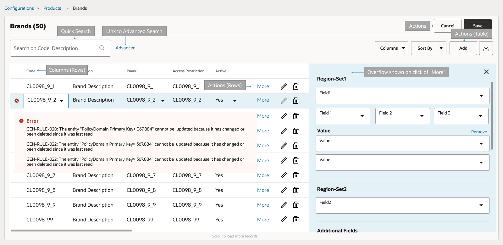

Page Layout
view-and-edit-object-list-layout

Entity Name and Results Count
  • Non-configurable, default functionality
  • The entity name plural is displayed above the table. The total count is displayed next to it
  • The count is only displayed when the user has performed a search
  • If no results match the search criteria, the message indicating that no rows were found is displayed by the results component

Table component consists of the following sub-components:
  • Actions (Table Level)
    • The Add button is displayed at the table level when configured.
    • The Add action adds a new record to the object list; that is, a new row is added to the top, with check (Apply) and cross (Cancel) icons.
    • The check adds a new row to the table, and the Save button saves the row data with any changes made to the table.
    • The Columns dropdown is displayed when flexcolumn setting is set to true.
    • The Columns dropdown is displayed at the table level when more than seven columns are configured on the desktop.
    • Used to display columns in a table by selecting or unselecting options from the Columns dropdown.
  • Rows
    • Rows can be configured with the following components:
  • Actions
    • 'Copy', 'Remove' is displayed for each record when configured in the row component
    • Action 'Remove', deletes the object from the list
    • Action 'Copy' clones the selected object and creates a new entry in edit mode.
  • Columns
    • Each property defined in this section forms a column in the table.
  • Labels
    • It is used to display property values in form of a label and can take in exactly one property per label
    • Multiple labels can be added to the results
  • Region
  • Used if additional properties need to be displayed for the row overflow region
  • The region will slide in from right hand side of table on clicking "More" link, with X (close icon) to close
  • Set 1 and Set 2: Sets are used to display multiple properties as a set. Each result can have up to 2 sets.
  • It is recommended to use only Set 1 when using the filter component on the page.
For more details refer Table component page
