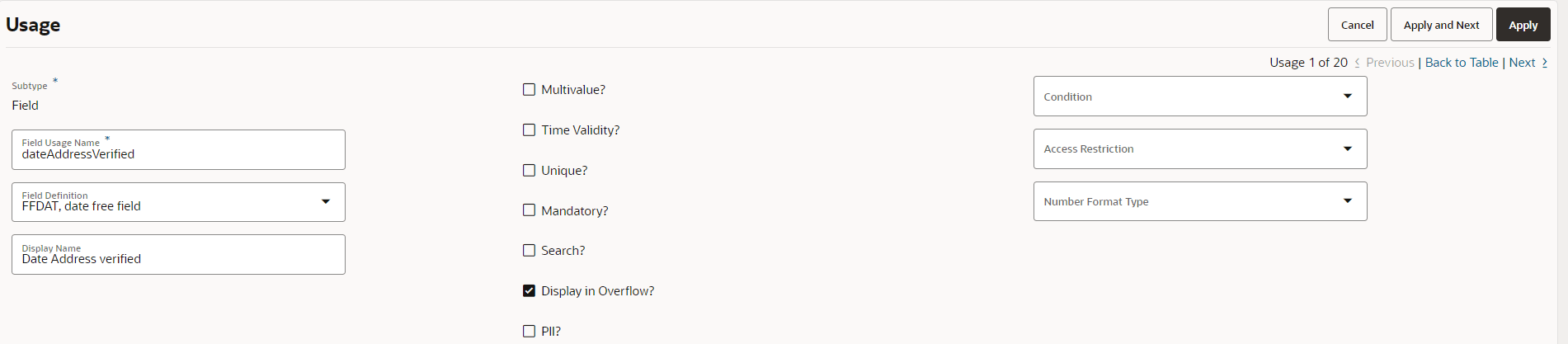

Adding Dynamic Fields and Records
A dynamic field usage links a table (entity) to a configured dynamic field that extends the table.
  • Not all tables can be extended with dynamic fields.
  • Some tables only support specific dynamic field types. For example, a table might allow time‑valid fields or might not support details.
A dynamic field usage has the following attributes:

Depending on the sub-type, a dynamic field usage refers to either a field definition, a code definition or a record definition.
Only usages for fields can be configured as unique. A dynamic field usage of the type Field cannot be both unique and have multiple values. The unique indicator can no longer be checked once actual values have been stored for that usage.
