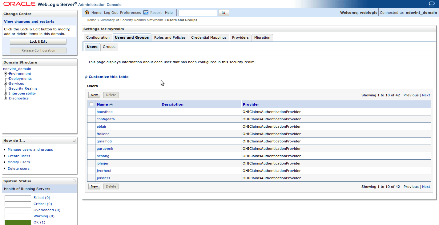

Optionally, verify that the authentication provider is configured successfully (after the WebLogic Server is restarted) by following the steps mentioned below:

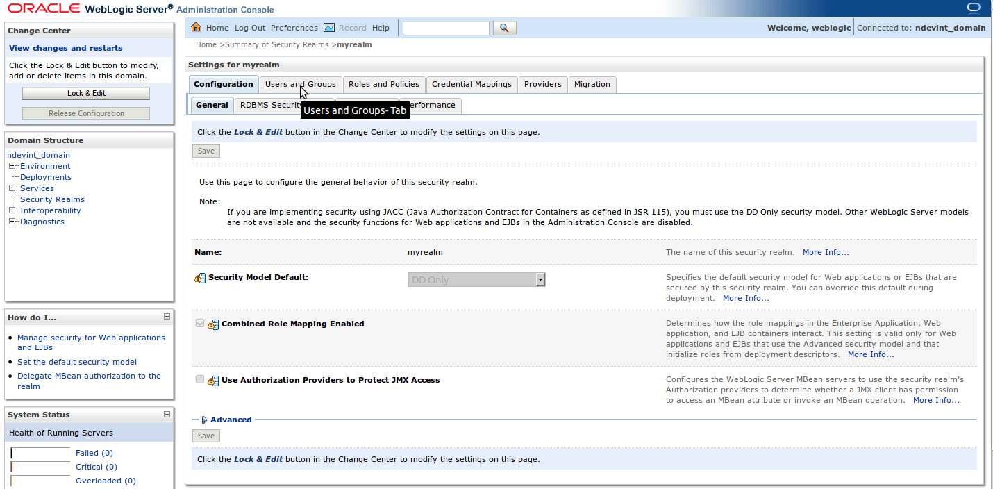

  1. Login to WLS Admin Console and click Security Realms.
  2. Click myrealm.
  3. Click the Users and Groups tab.
    users and groups
  4. See the list of users from OHIAuthenticationProvider (in addition to the default users from DefaultAuthenticator).
Users

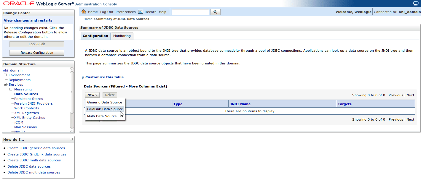

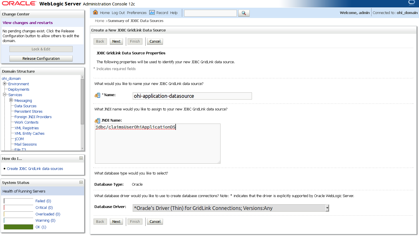

  1. Login to the WebLogic admin server console and click the Services/Data Sources link.

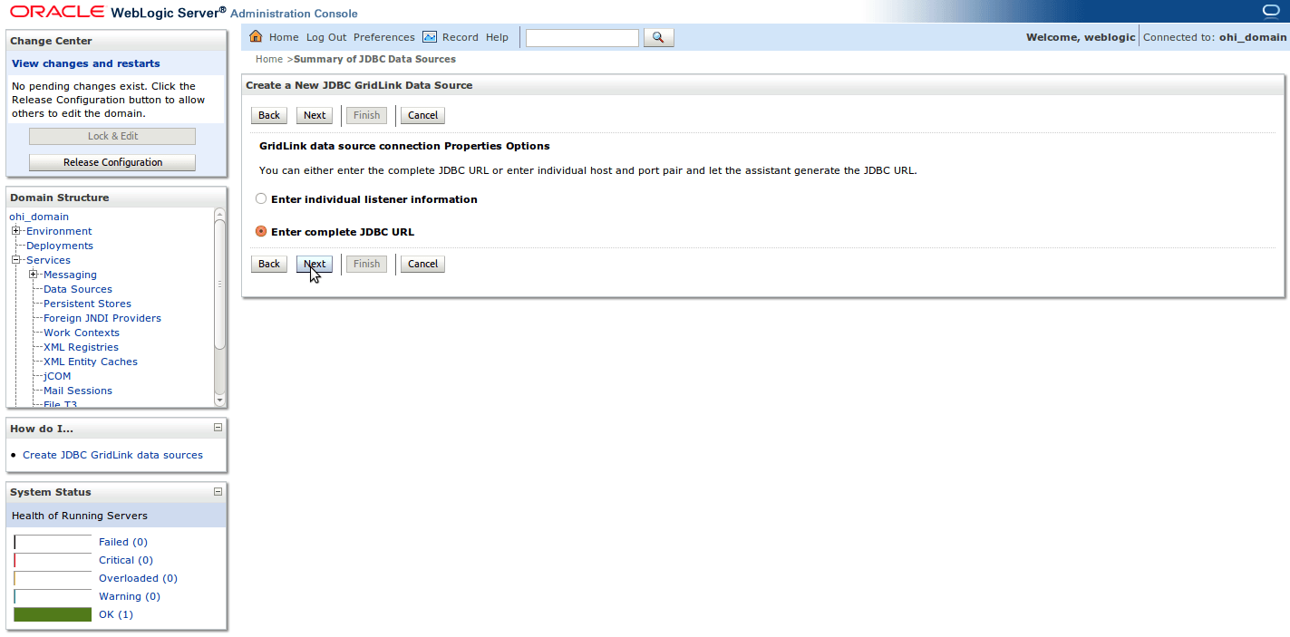

  2. Click New and select the option GridLink Data Source.
    create new gridLink data source
    In the WLS Production-mode use the Lock & Edit button before clicking the New button.
  3. Change the value of Name to ohi-application-datasource and enter jdbc/claimsUserOhiApplicationDS in JNDI Name. Click Next.
    gridlink datasource props

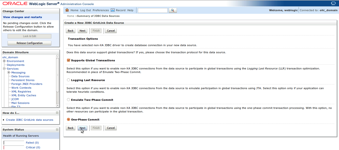

  4. In the Transaction Options page, accept the default settings (Supports Global Transactions and One-Phase Commit) and click Next.
    Transaction Options
  5. If SCAN (Single Client Access Name) is used for the Oracle RAC database, select the option Enter complete JDBC URL. Else, select the option Enter individual listener information.
    gridlink data source connection properties options

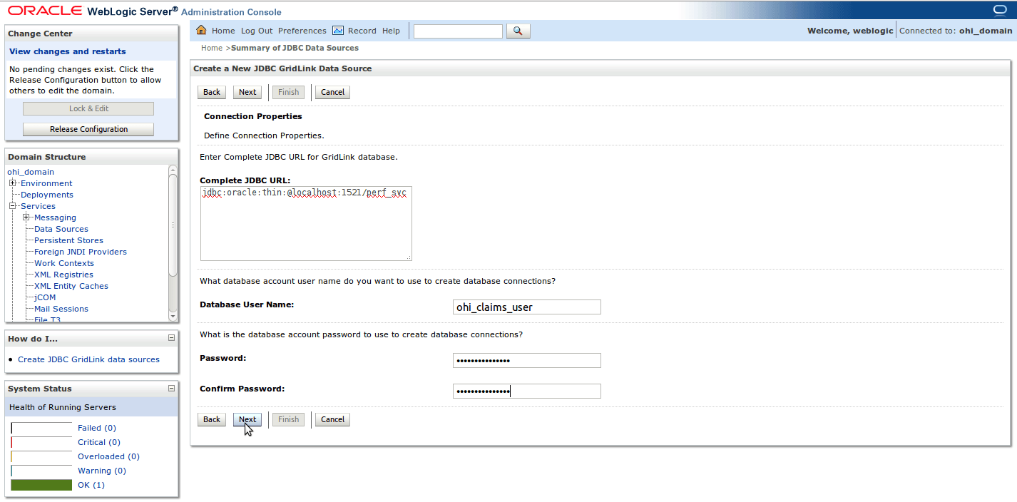

  6. In the Connection Properties page either:
    • enter the values of various fields as outlined in the table below if option Enter complete JDBC URL is selected:
    Table 4. Values to Enter
    Parameters Value Explanation
    Complete JDBC URL
    jdbc:oracle:thin:@\{scan-listener-host}:\{scan-listener-port}/\{service-name}
    JDBC URL using SCAN
    Database User Name
    ohi_claims_user
    Fixed value, do not change
    Password & Confirm Password
    Password of "ohi_claims_user"
    The schema password as selected during the installation
    • or enter the values of various fields as outlined in the table below if option Enter individual listener information is selected:
    individual listeners connection properties

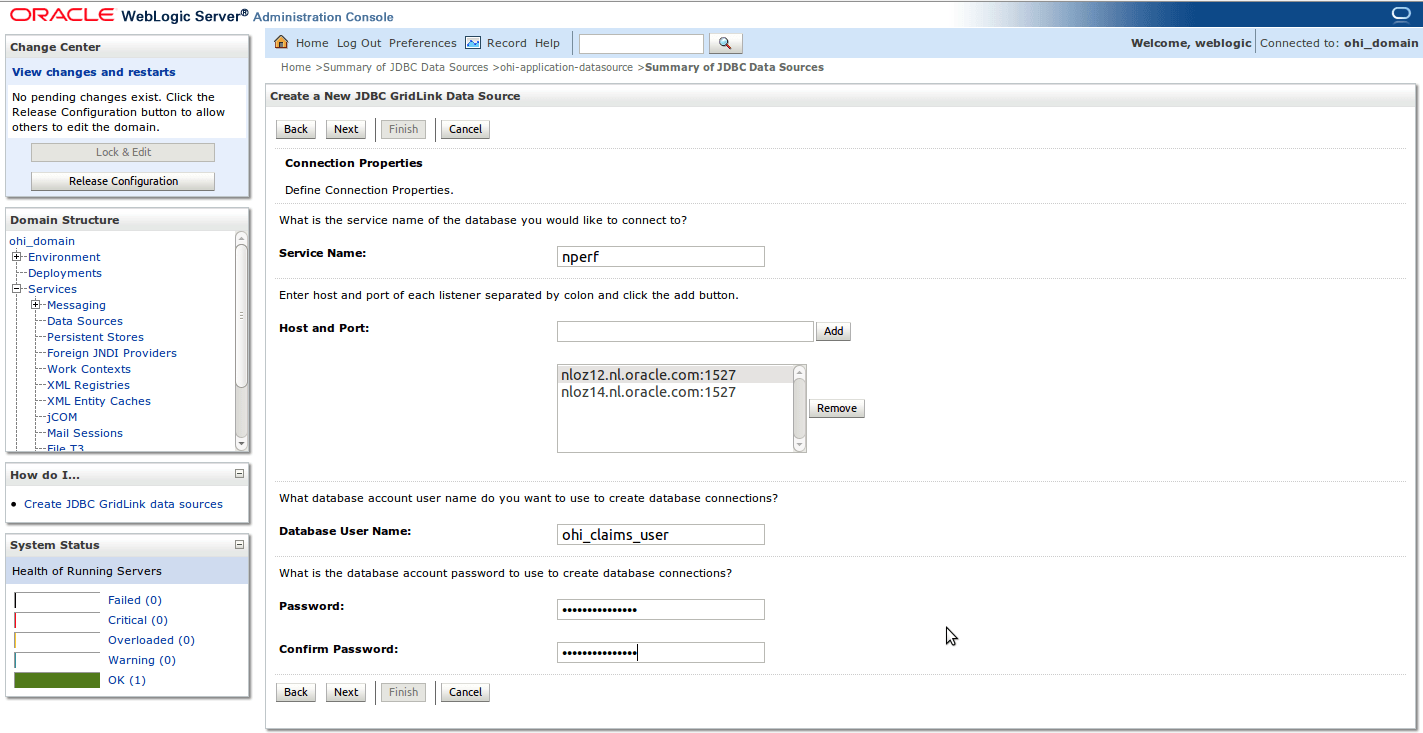

    Table 5. Enter Individual Listener Information
    Service Name
    Oracle RAC service name
    Host and Port
    hostname1:port
    hostname2:port
    Individual RAC node details. The format is <HOSTNAME>:<PORT>
    Database User Name
    ohi_claims_user

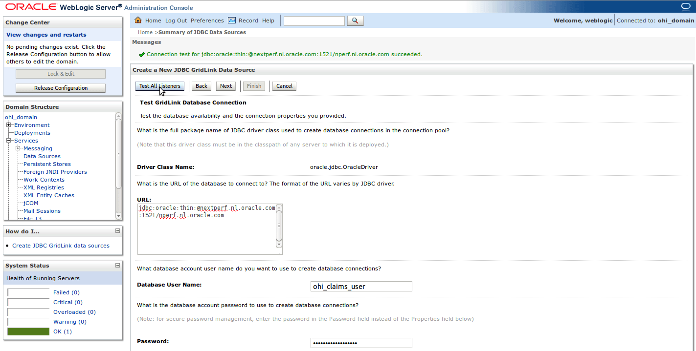

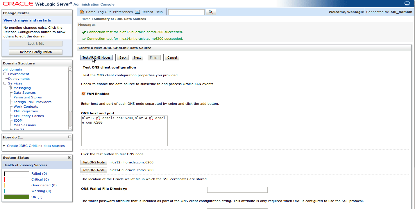

  7. In the Test GridLink Database Connection page, click the Test All Listeners to see if the connection is successful. Once the test connection succeeds, click Next.
    test grid link database connection

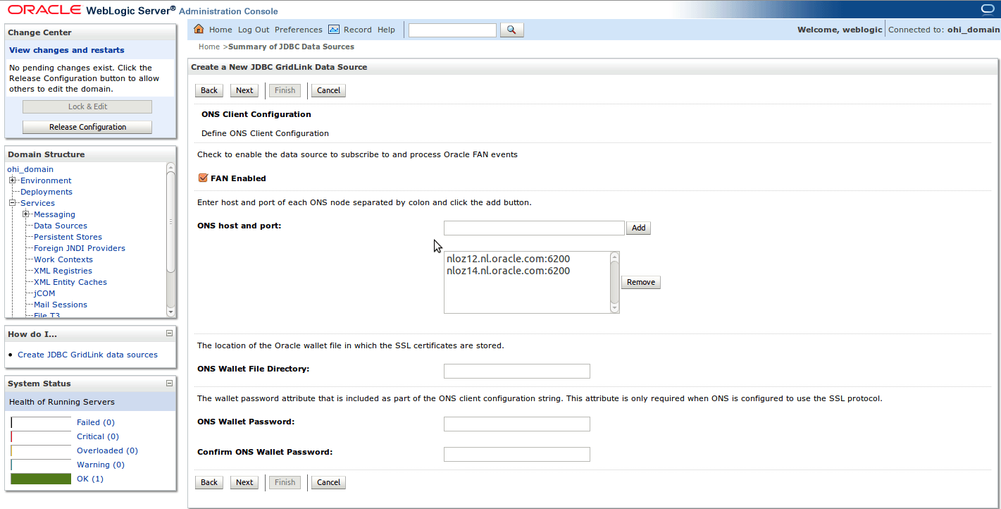

  8. Enter the details of the ONS client configuration as outlined in the table below and click Next.
    ons client onfiguration
    Table 6. ONS Client Configuration
    Fan Enabled
    Check-box selected
    Enables the data source to subscribe to and process the Oracle FAN events. This attribute is only applicable for the RAC configurations that publish the FAN notification events using the ONS protocol.
    ONS Nodes
    For example: hostname1:6200,hostname2:6200
    A comma-separated list of ONS daemon listen addresses and ports to connect to for receiving the ONS-based FAN events.
    ONS Wallet File
    Location of ONS Wallet File (including the file name)
    The location of the Oracle wallet file in which the SSL certificates are stored. Only required when the ONS client is configured to communicate with the ONS daemons using SSL.
    ONS Wallet Password & Confirm ONS Wallet Password
    The wallet password
    The wallet password attribute that is included as part of the ONS client configuration string. This attribute is only required when the ONS is configured to use the SSL protocol.
  9. Click Test All ONS Nodes to see if the connection is successful. Once the connection test succeeds, click Next.
    test ons client configuration
  10. Select the Targets in the next page and click Finish.
    image::select-targets.png[]. Make sure to specify the managed server as target for the GridLink Data.

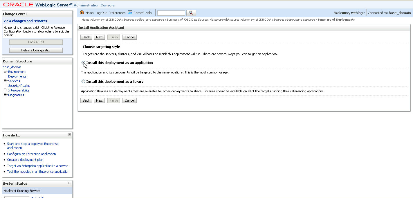

Installing The Oracle Health Insurance Application through the Admin Server Console
Oracle Health Insurance applications are delivered in a so called Java Enterprise Archive (EAR) which is installed through the WebLogic Admin Server Console. In order to do that, perform the following steps.

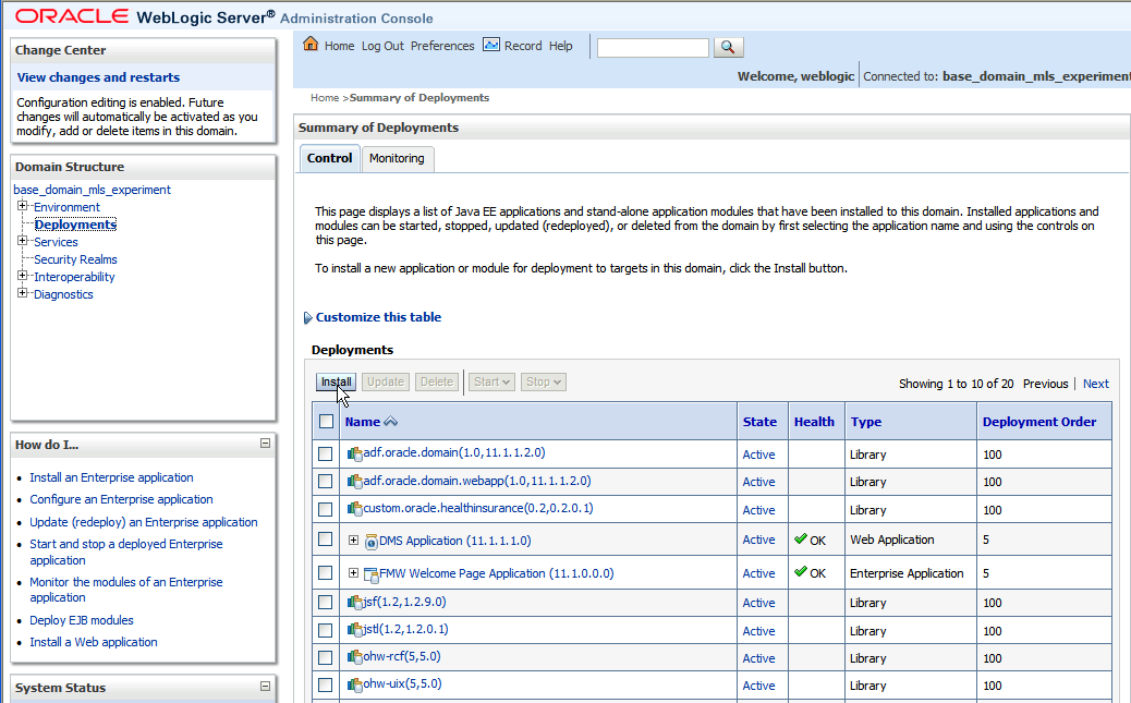

  1. Login to the Admin Server console (for example:).

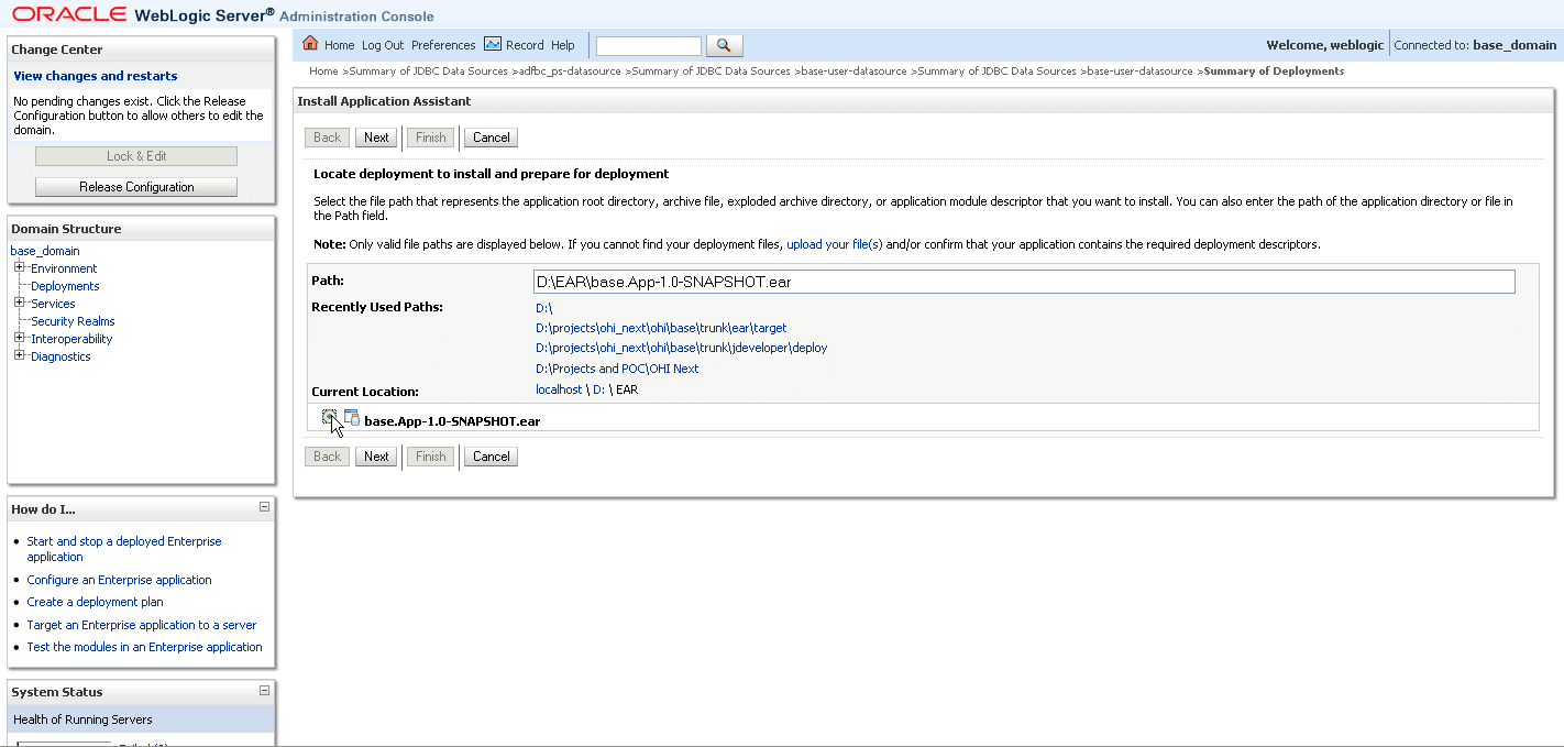

  2. Click the Deployment link and then click the Install button as shown in the following screenshot:
    install application
  3. Select the path where the EAR file is located and click Next as shown in the following screenshot:
    snap 2
  4. Select the option Install this deployment as an application and click Next as shown below:
    snap 3 1
  5. Click Finish. The Oracle Health Insurance application is now installed.

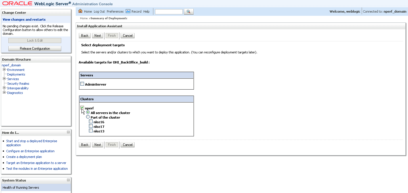

  6. When deploying the application to cluster, in Select deployment targets page, select the Clusters target as shown below:
    install application assistant
