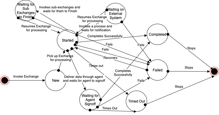

Exchange Status
Following exchange states are possible:
State
Description
Final State
Recoverable State
New (N)
Whenever a request comes in for the execution of a message exchange, this exchange will get the initial status of 'NEW'
N
N
Started(S)
Whenever the exchange is picked up by the system to go through the various steps it will have a status of 'Started'
N
N
WaitingOnExternalSystem(W)
Whenever fulfilling the exchange is (temporarily) depending on an external system, the exchange will have a status of 'WaitingOnExternalSystem'
N
N
WaitingForAgentToSignoff(A)
Whenever fulfilling the exchange delivery through agent, the message is sent to Agent and when Agent finally delivers it, it signs off the gateway. In the interim, the status on the exchange is 'WaitingForAgentToSignoff'
N
N
WaitingForSubExchangesToFinish(WS)
Whenever an exchange reaches an exchange step that triggers sub-exchanges, the main exchange needs to wait before it moves to its own next step. In that case, the main exchange is put to this status.
N
N
Failed(F)
Whenever the message exchange has somehow resulted in a (temporary) error, the exchange will have a status of 'Failed'
Y
Y
TimedOut(T)
Whenever the message exchange did not meet the configured SLA, maximum time allowed it is marked as Timed Out
Y
N
Completed©
Whenever the message exchange has been 'signed off' by the requesting party, it will have a status of 'Completed'
Y
N

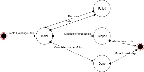

Exchange Step Status
Following exchange step states are possible:
State
Description
Initial(I)
Whenever a request comes in for the execution of an exchange, the exchange step gets the initial status of 'I'
Skipped(S)
Steps conditionally can be skipped in which case they get this status.
Failed(F)
A failed step ~ possibly this can be recovered.
Done(D)
A step which has completed its work gets a 'Done' status.
